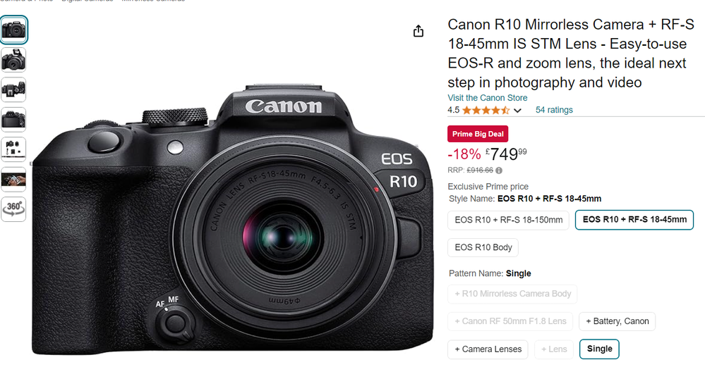

Trevor thank you! Sorry im new to this.
She use to have a canon camera but got rid of it when we moved house, she loves photography but just uses her Iphone (16 now) to take it and now wwant to get her one back.
Im looking at getting this for her: [for safety reasons, posting links to third-party sites is not allowed]
With this lense: Stephen_1-1728401406303.png
Is this good enough or?

The body is OK, the kit lens that comes with it, not so good. The 50mm lens on that body will be too narrow for northern lights I think - on that body, a lens like the RF 16mm f/2.8 would be a better choice specifically for northern lights but will also do a good job for landscapes. Shop Canon Refurbished RF16mm F2.8 STM | Canon U.S.A., Inc.
(Refurb lenses are usually new but overstock, open box but unused, show or demo units but 'good as new' and with a Canon warranty - and you get a price break)
Assumedly you are not making a journey just to look at the sky, so an ultra wide-angle lens is going to be less useful for other subjects. You might get away with the 18-45 but its focal length is quite limited so, if the site offers an option for the RF-S 18-150, I would go for that.
Having checked, I see: EOS R10 RF-S18-150mm F3.5-6.3 IS STM Lens Kit (canon.com)
The point is that afterwards the combination of lens and body will offer much more flexibility use options and ultimately better value for money if they continue to use the gear.

I would concur with Trevor's advice. The R10 with an 18-150mm lens kit would be a good choice - for the Northern lights and beyond.
The kit he suggested is currently running at $1,279. You'll want to add some money for a couple of memory cards, a spare battery, a camera bag and perhaps a good tripod.
Those are all considered to be accessories, and are not included in the camera price.
