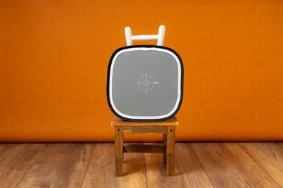

Here is the set of photo with the gray target, seems to be balanced with lightroom eye dropper on the target

Do you get the same result if you do a "click-on" white balance on a white surface as opposed to grey ?
Have you tried Canon's DPP software, if that gets it right then you know it's an Adobe camera raw problem.
EDIT ...
on reading your initial post again I am confused as to whether you are expecting the camera to get the balance right in the first shot with the target or are adjusting it in post using the target as a reference.

A little bit less yellow but still oversaturated! The thing is any target i use makes similar result, i grabbed 5 d mark ii and snapped same images , ran them through lightroom and perfect balance no yellowish tones , to get a good result i have to manually calibrate it, doent seem the right way to work
"...  i have to manually calibrate it, doent seem the right way to work"
it isn't right but you need to be working on the correct solution. The exposure changed. Did you try to add some exposure to see if that corrected it? It is almost impossible to not be able to fix WB using Raw format. I don't know and not having a EOS R to try, however, it may just be how the camera/sensor works together.
