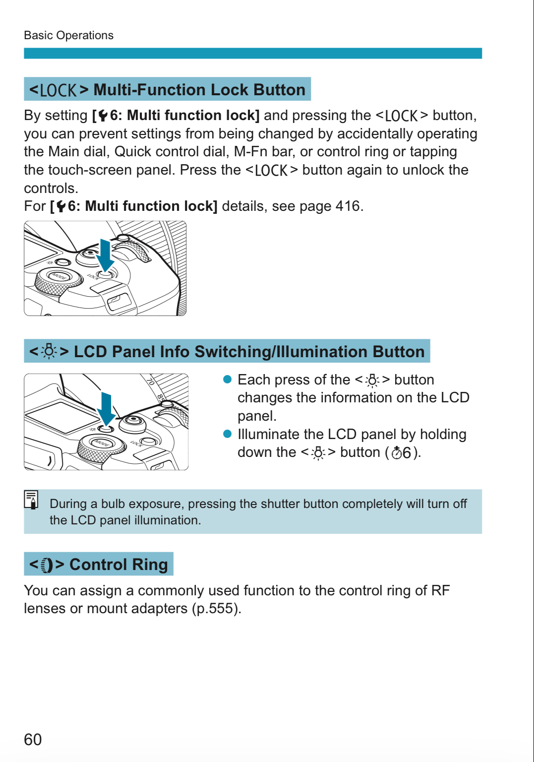

Use the Multi-Function Lock button.
You toggle it ON/OFF when you want to either use the touch screen or to disable it.

Unfortunately, the lock button does not stop the touch screen from changing the focus point. It seems as though it should.

Did you program the button?  Notice the "Wrench 6" icon.  That's the menu screen where you program the button.
Do you see the little finger?  Check that one.
"The right mouse button is your friend."
The lock button has not been reprogrammed. When I hit the button the screen says that the controls or settings are locked, but I can still change the focus point.

That is not the behavior that I expected.  I suggest you contact Canon Support, dial 1-800-OK-CANON for US users.
