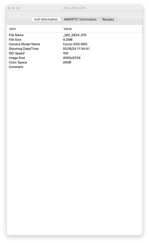

I downloaded your larger image and it has been edited, so I cannot read the detailed camera settings using Canon DPP software. Here's an example of the detailed settings I can see for an EOS M50 Mk2 JPG image straight from the camera.
This is what I see from your image.
If you can give us a screenshot like this from your image then it makes it easier to help you.

Thanks for the RAW file NickSlav, and to zakslm and Trevor for the decoded info.
I don't see anything in the EXIF that would point to a camera settings error. I have two thoughts;
