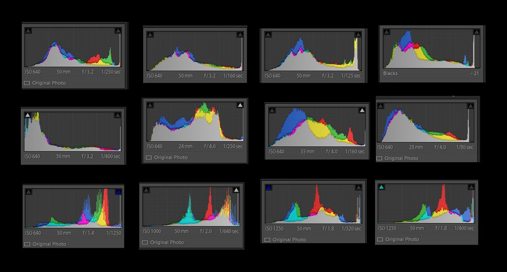

My EOS90D began an issue where whatever is brightest in a shot is spiked too bright and lost for no reason. I'd say it has something to do with metering and or white balance. Any lens, any ISO, any mode, 95% of my images have an odd histogram spike on the right, even if I shoot something relatively dark. below are two examples with the blowout but I have a couple hundred that I am finding the spike over the last couple weeks. Does anyone has insight into what is going on or what might correct the issue? thanks

The spike to the right is there because you clipped the highlights. You probably clipped the highlights because the dark clothes and the dark background fooled the light meter. You camera wants to expose for 18% grey.

Thanks for the reply Peter. It seems that even when I attempt to expose for the highlights or there is a scene that doesnt have a particular bright spot, the camera is finding the brightest area and blowing it out. Its occurred in several scenes, locations and settings. The issue is found with any combination of metering, white balances, ISO, or lenses. I am 99% sure it is a metering or sensor issue. Ive reset to factory to no avail. Ive looked through several online communities and found a few similar topics however nothing with a definitive explanation or correction. I'll most likely have to take it in for service if it is not something simple. Im unsure if I'm looking at a modest repair cost or a total loss.

Of my last 400 shots, 340 have these odd brightness clip histogram spikes. attach is a sampling but 85% all have these.

It will really depend upon the scene. Cameras are limited to the total dynamic range that can be captured in a single image. So in high dynamic scenes, you have to ultimately choose the best possible exposure for your subject. Then, either sacrifice shadows or highlights a bit.

As rs-eos wrote you have high dynamic scenes. Your camera needs to choose something. Clipping the highlights or crushing the shadows.
There are two light meters in 90D. One in the viewfinder, at least that is the case with older DSLRs, and the other one is the sensor when using live view. You can try both using the optical viewfinder and live view. What if you take a picture of a grey wall? Over exposed?
About your histogram I guess, and I am not familiar with Lightroom, that your histogram doesn't show you clipped raw data. If you move some sliders your histogram moves too, doesn't it?
