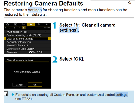

I am going to recommend that you do a full reset of the camera.  This can be a little time consuming.  While there is a menu setting that resets the camera back to factory defaults, it does not completely reset the entire camera.  That function resets everything that does not have a custom sub-menu.  These menu items have their own reset option.
Set the top shooting dial to P.  There should an option in the Wrecnh menu to “Clear All Camera Settings”.  Select it and choose “OK”.  Let’s stop here and see if the issue has gone away.

I did put it on P mode and went to Wrench 5th page and did the Clear all camera settings -> no change (now I have bluetooth on always. I think this is the only setting I did do initially).
I then googled and found out that I must press Menu button while turning ON the camera and then go to Clear all camera settings -> no change.

Hello, the issue did not go away (I tried multiple ways to clear the settings, via P mode, B/M and from OFF position I was holding Menu and then turning on the camera while holding Menu - then clear). None work. All manual modes (B,M,P,Av,Tv) turn off the OS while the other modes leave it open.

I realized that you have tried a reset but have you tried a full factory reset of the camera yet, as per the option in the wrench menu, page 5:
followed by Clear Custom Functions:
Given your lack of success so far, this is worth a try, I would suggest...
