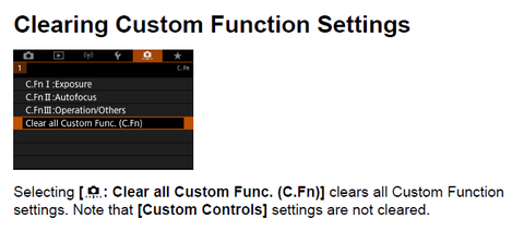

I realized that you have tried a reset but have you tried a full factory reset of the camera yet, as per the option in the wrench menu, page 5:
followed by Clear Custom Functions:
Given your lack of success so far, this is worth a try, I would suggest...
cheers, TREVOR
Hello, thank you, yes I did that already. Those easy to find on Google steps I did. I don’t know if there is another step something like putting an sd card etc.
