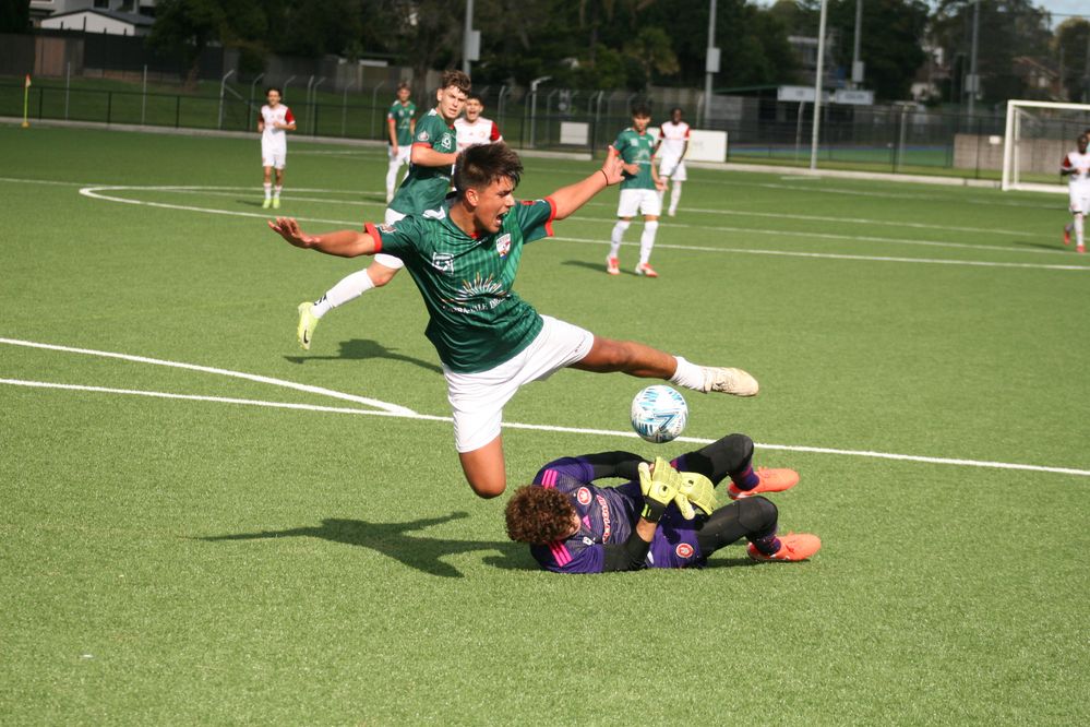

As far as my positioning goes I do get on field or along the fenceline - depends on which ground of course. Because my son is an attacking midfielder I would usually shoot from behind the line at the oppositions goal to get the attacking shot as they are running in, depending on the position of the sun of course (shadows). Admittedly I shoot jpg (not raw) and just crop them as needed to get them out to the team quickly but will now try RAW and use the DPP4.
These shots are the old 30D before it died. The AF setting on the 30D are much more simpler than the 80D so I am looking at settings on the 80D more so than my positioning and understanding of the game. hopefully would liek to get back the colour depth with the 80D that I once acheived with the 30D Canon EOS 30D 100mm f/4.5  1/4000  ISO 500Canon EOS 30D 100mm f/4.5 1/4000 ISO 500Canon EOS 30D 75mm f/4.0  1/6400  ISO 500Canon EOS 30D 75mm f/4.0 1/6400 ISO 500
“ These shots are the old 30D before it died. The AF setting on the 30D are much more simpler than the 80D so I am looking at settings on the 80D more so than my positioning and understanding of the game. hopefully would liek to get back the colour depth with the 80D that I once acheived with the 30D “
What AF settings did you use on your 30D?  I believe your choices were all, one, or none.
On the 30D I would use all but if there was too much signage distraction I would switch it off. But 80D has 4 different sets of modes for AF so dozens of options...
Nice captures and I would definitely restrict the focus points to a small array because that is what gives you necessary control over the camera to capture what you want.  With your field position, this will give you a very good setup for soccer.
Depending upon the sport, I will use either a point in the center of the array or lower center area.  I can't remember the full capabilities of the AF array in the 80D so look at your manual for specifics.  Canon has different levels of AF points within the array with the most capable functioning as dual cross point sensors which provide the highest level of performance.  The performance of the points is also controlled by the maximum capable aperture of the lens (not what is selected in your exposure setup) so if only the very center points function at maximum level with the aperture of the lens you have then use the center of the array instead of the bottom center.
