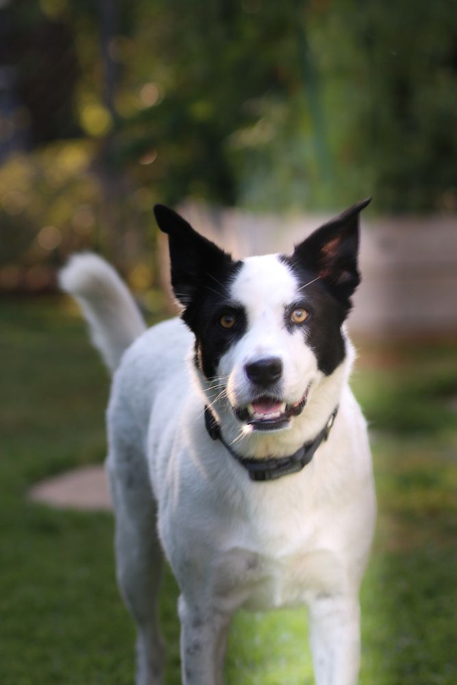

A band of light is showing up on 90% of pictures. Tried changing lenses and it made no difference. Does anyone know what could be causing this?Light Artifact Sample 1Light Artifact Sample 1Light Artifact Sample 2Light Artifact Sample 2

I believe a similar issue was recently diagnosed in another thread.  This appears to be a failing shutter.

Thanks for the reply! Yes, I did a more thorough search and the shutter is the issue. Looks like the repair cost will be around $300? There is a Canon Service Center in Burbank which isn’t too far from me so will drop it off when they open on Monday. The camera body is probably not worth much more than $300 (its 10 years old +). I’m wondering if I should put the $$ towards a new camera? Would appreciate any recommendations. Thanks!
