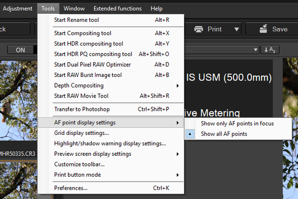

Bill, do you have the Canon Digital Photo Professional (DPP) software. If you don't the link provided will get you there and it's a free application. It gives you the ability to look at your exact focus points which let's you know if you hit the subject matter in the way you intended. It also has some decent features for post production. If you already knew this sorry for the redundancy.
  • Tools
  • AF Point Display Settings
  • Show all AF points

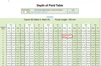

It looks to me like the camera is back focused a little bit in this shot.  3' away at f10 with a 100mm lens gives you under 2" of depth in focus and if you are looking at it very critically (like you would with a macro setup) then the "perfect" depth is even shallower.
  • Tools

I don't have it. thanks. I will check it out.
