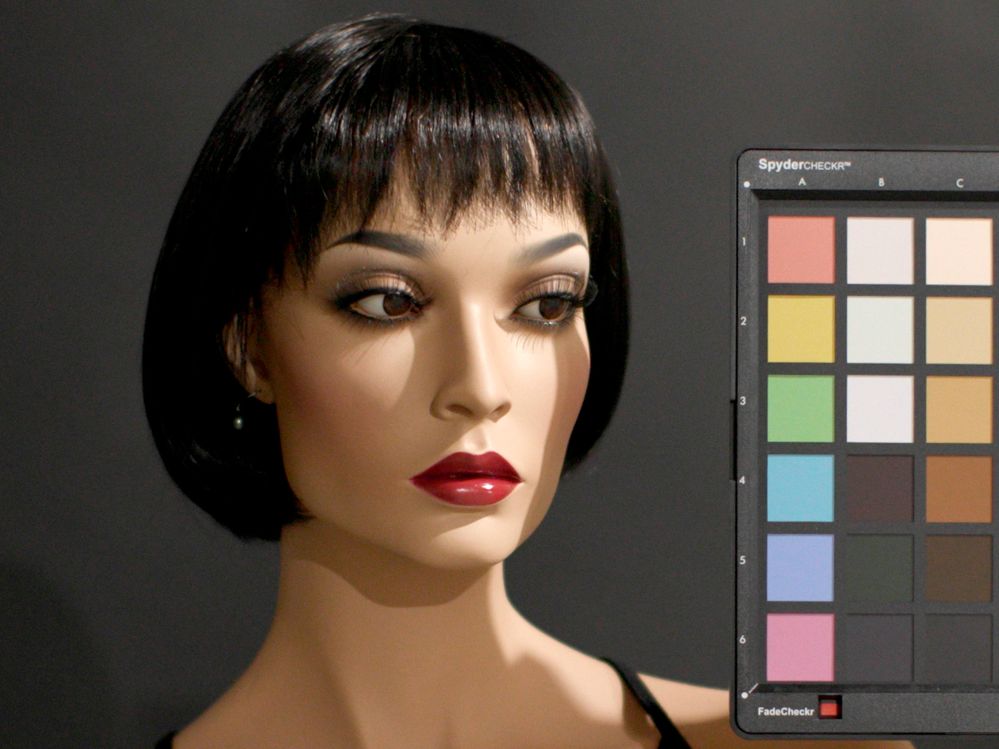

I botched my first test using a 50mm f/1.2 on both the 5D IV and EOS C70.  Will re-run things properly tomorrow.
Having said that, the 5D IV footage was definitely softer.
Ricky
I'm not seeing an issue with video from the 5D IV.   I used an EF 50mm f/1.2 L lens at f/1.8.  This lens at that aperture is still a bit soft and it was definitely the limiting factor in my testing.
Setup:
Common items: Single 5000 K light source (continuous), 5D IV and C70 both set to 5000 K.  Lens at f/1.8
Note: You'll see slight differences in where objects are within the frame.  This is due to the 5D IV 1.7x crop factor that is applied.  And the C70 is not exactly at 1.0x crop factor with the 0.71x adapter.  I did my best to frame both videos the same.
First, here's part of still frame from the DCI 4K footage on a 5D IV.   Settings were 23.976 fps, 1/50 shutter, f/1.8, ISO 1600.  Codec: MJPEG.  Rec-709.
5D IV MJPEG DCI-4K sample (cropped)5D IV MJPEG DCI-4K sample (cropped)

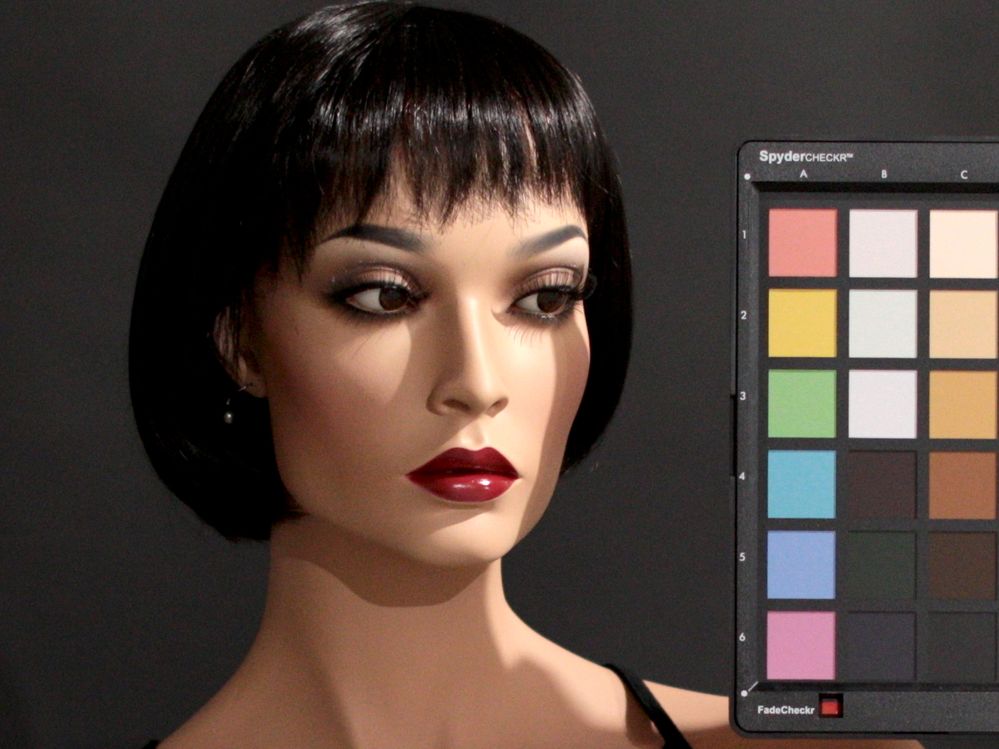

Next, here's the 50mm lens on my C70 with the 0x71x adapter.  I wanted to keep the aperture the exact same, but due to the 2x multiplier in light gathering, I lowered the ISO.  Settings were 24 fps, 1/48 shutter, f/1.8, ISO 800.  Codec: 12-bit RAW ST.  CLog2
C70 RAW ST DCI-4K sample (cropped)C70 RAW ST DCI-4K sample (cropped)
When I injested the footage into Final Cut Pro, it really crushed the blacks for the 5D IV footage, so needed to apply a 14% increase in global exposure.   For the C70 footage, I applied the "Canon Log 2/Cinema Gamut" LUT for this test.  Usually I prefer the "ARRI Log C" LUT, but the Canon LUT more closely matched the 5D IV footage.  I did some global adjustments to exposure though: lowered the shadows and raised the highlights (mids left as-is) in order to match the Rec709 footage of the 5D IV.
Now then, when I use the RF 24-70 f/2.8 L IS lens with the C70, I will end up with a decent jump in sharpness (even when the EF 50mm is at f/2.8).  This isn't surprising.
Finally some observations:
Color.  The 5D IV footage (DCI 4K) using 8-bit 4:2:2.  The C70 was 12-bit RAW, but the minimum being 4:2:2 here is good enough for this test and most video.   8 bits though is not the best though on the 5D IV.   And if you're capturing in HD, it's worse as you'll now have 8-bit 4:2:0 footage.    Still, I don't see banding in this particular test.   The 5D IV footage though contains more red.   Both the 5D IV and C70 are effectively set up to capture "Faithful" images/video.   My guess is this is just the LUT that was applied in camera on the 5D.  The C70 produced more faithful colors to what my eye sees.
Noise.  A bit unfair since the 5D IV was set to use 1600 ISO vs the C70's 800 ISO.  I don't have a plain EF to RF adapter, so had to compensate for the 0.71x adapter.   Still, it's not bad.
Aliasing. I don't see any issues with aliasing with either camera.
Dynamic Range.  I chose a low dynamic range scene on purpose.  Since the 5D IV really cannot match the C70 at all regarding video dynamic range.
In summary, I'm just not seeing any issues with your footage beyond it being a bit soft.  So ensure your focus is locked on whatever it needs to be.   Perhaps is just that in video mode with this particular lens, that things are a bit soft as well?
If you're not shooting in 4K on the 5D IV, you may want to do so to get twice as much color info recorded (8-bit 4:2:2 vs 8-bit 4:2:0).  Especially if you need to do lots of adjustments in post.  The downside to 4K on the 5D IV is the absolutely massive files.  MJPEG is really not a good codec at all for working with video.
If you need to capture high dynamic range footage, the 5D IV (or any camera/camcorder) without Log will be quite a limiting factor.
So, again, I'll ask one more time what you mean by poor quality.  Color? Noise? Dynamic Range?  Some other factor?
Ricky
