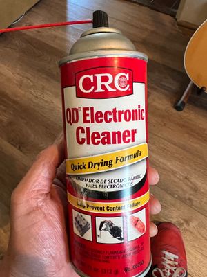

I know this is an older post, but one of my 5D MK IVs was having this same intermittent dial issue, sometimes adjusting shutter speed the opposite of dial direction. I sprayed some Electronic Parts cleaner in/around the dial and worked the dial in each direction while it was drying. It took a couple of applications, but seems to have completely fixed the issue. Many people seem to have this issue, so hopefully they'll find this.

That would not be my first choice of action and I will advise folks to not do that. Who knows if it worked or was a coincidence but spraying cleaner in an area you can't see in is not a good idea, IMHO, of course.
