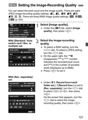

I have my 5D3 set to record to separate cards.  I have #1 CF card set to sRAW & #2 SD set to RAW.  I have Record Function set to Record separately, Playback set to card 2.  I shot a wedding yesterday and imported both cards to a separate folder thru Adobe Bridge.  During processing I noticed differences in dimensions in the same folder.  The folder I imported from the CF card had both 5760x3840 & 2880x1920 images.  Same thing for the folder with the images from the SD card.  I haven't noticed this before & the only thing different I used was a Canon 24-105 F4L lens that I just got which shouldn't matter.  I can put all the images in one folder and sort by dimensions and then move each size to another separate folder, which is a pain.  Any suggestions on something to look for.  Firmware version is 1.3.6.  Thank you in advance.

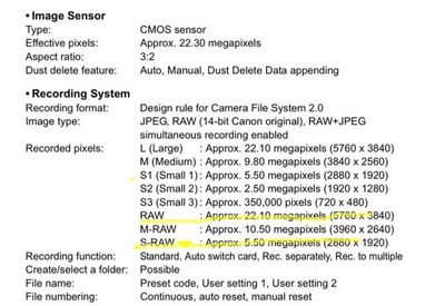

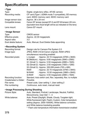

I think I have solved your mystery. The image sizes are normal.  The s-RAW format is a smaller file size with less resolution.

What you’re seeing is normal. I posted the specs, but somehow the post is on page 1.

Where did you get that idea? I am only trying to tell you that the reduced image resolution for sRAW  is normal.

Well I happened to stumble on the reason by accident.  The C1, C2, & C3 settings all showed the CF set to sRAW and the SD card set to RAW.  When set to M the CF is set to RAW & the SD is set to sRAW.  Checked and if using Av, Tv, or P the CF is set to RAW and the SD to sRAW.  I switched a few times between shooting Manual and using C1, C2, or C3.  I went back at the images and looked and the exif and it matches the changes.
At some point back in time I had the CF set to sRAW and registered C1.  After that I'm guessing I used it as a base for C2 and C3.  After I switched the CF to RAW and the SD to sRAW the C1, C2, C3 kept the original settings of the way I had the cards to shoot.
Thank you for posting the resolution.
