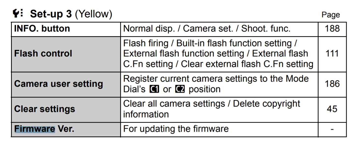

Thank you so very much. How can I tell which version of firmware is on my camera currently?
07-24-2017 09:55 PM
You can get a PDF of the 50D manual here. I do recommend reading it.
http://gdlp01.c-wss.com/gds/1/0300001591/02/eos50d-h2-en.pdf
You can find the Firmware version and update the firmware under yellow wrench 3 in the menu.
