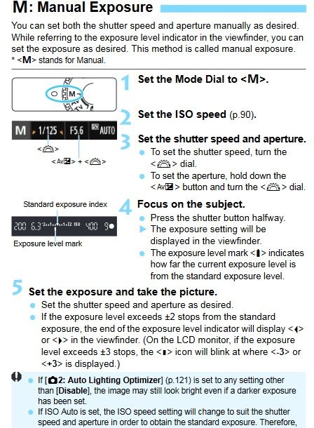

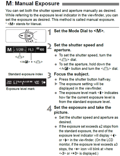

The manual setting is based on the image, there is no one "manual" setting.

What are you shooting?
As above, you adjust the shutter speed or aperture to get the "exposure level mark" to line up with the "exposure level index"

Really, as my respected colleagues have said, there is no 'default setting' for M mode.  The whole point of the mode is that you control ISO, shutter speed and aperture yourself and the camera makes no decisions for you  This allows you the maximum creative control but relies on you to make a lot more decisions that might be a touch challenging right now.  For controlling exposure, it relies on you looking at the display on the bottom of the screen where there is a vernier going from -3 to 0 to +3.   This is your exposure meter and for most images you want to manipulate the three controls to get the small triangle that represents your exposure at, or close to the 0.  Each of these values represents a doubling (as you move to the right) or halving (as  you move to the left) of the light the camera will capture.
