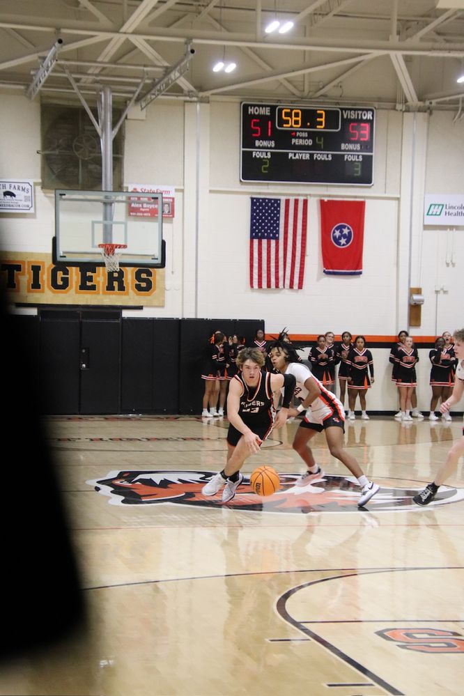

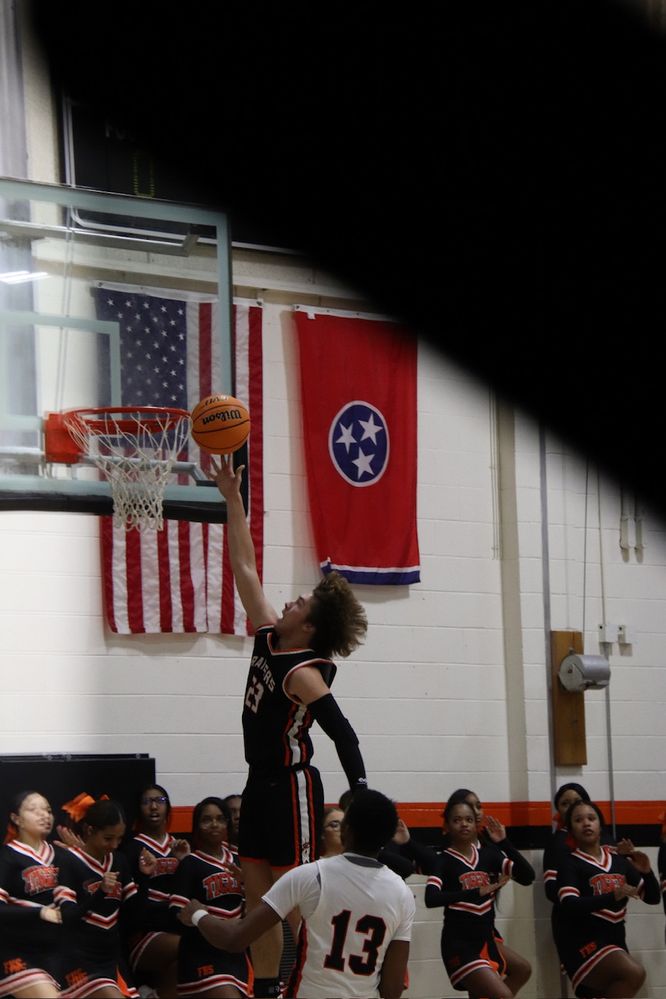

Here’s some examples. I have already deleted most of them but if you would like to see more I can take some. These aren’t the worst ones. IMG_9889.jpeg
01-04-2024 08:30 AM
Definitely looks like a failing shutter. Contact Canon to get an estimate for a repair.
