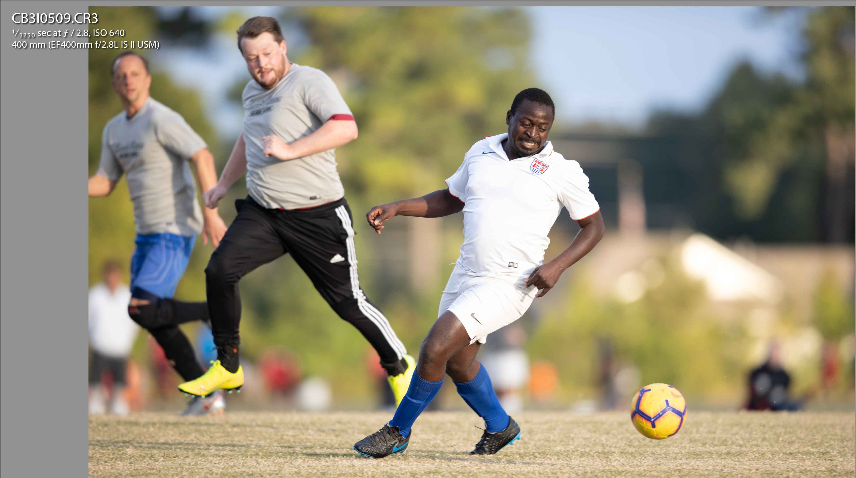

Canon 1DX MkIII. Auto ISO is all over the map, and occasionally producing wildly inconsistent exposures from one shot to the next. Consider the two attached pics. These were taken a fraction of a second apart. The first was taken at ISO 640 and is properly exposed. The next shot in the series the camera jumped to 1600 ISO and completely blew it out.
I did a screeshot from Lightroom so you could see some of the data. These shots were taken back to back in less than one second, nothing changed with the lighting on the field. This was shot in manual exposure with Auto ISO. Why did it blow out the second pic? This isn't an isolated incident, I've got several like this from this game. Heck, one of them jumped to 10,000 ISO in broad daylight, completely washing the frame out.

Spot metering would be more susceptible to something like this, although it is not super common. Without seeing the spot the camera is metering from (linked to AF point or not) I could not say for sure that this is the case, but the metering point being placed on a white jersey, for example, and then to a darker area of the frame could definitely cause the camera to bump Auto ISO since it will be trying to reach the same exposure of the previous white area.
One possible solution, other than switching to a metering mode with a wider sample area, would be to limit the Auto ISO range. In a shooting situation like the one you show I would probably preset the Auto ISO between 100 to 800 to keep the exposure within an acceptable range even if the metering shifts too far.

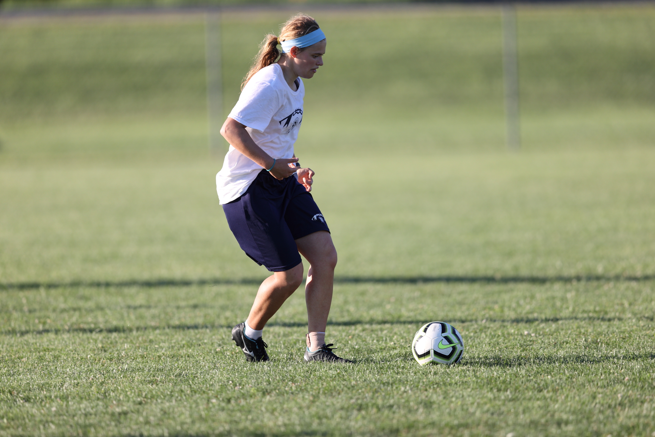

These two shots were taken with the 1DX III and EF 400 f2.8 at a summer soccer conditioning drill. They are RAW files converted in DPP with NO recipe or additional processing applied, just reduced in size during JPG conversion. In the first, the camera chose ISO 160 and the second frame went to ISO 100 for nearly a full stop difference.
I had been using the 1DX III earlier that day to shoot some technical photos of electronic gear and used spot metering for that and I initially forgot to change that for the practice I shot. But this shows what can go wrong with spot metering during sports. The camera is doing what it was set up to do by the user but that isn't the proper metering for this type of action shot. I caught that setup issue quickly and switched to partial for the rest of the shoot and the 1DX III exposure was consistent and correct. I always shoot sports in full manual, usually with the lens wide open, and the ISO at auto. It works extremely well under partial and probably would also with center weighted average.
