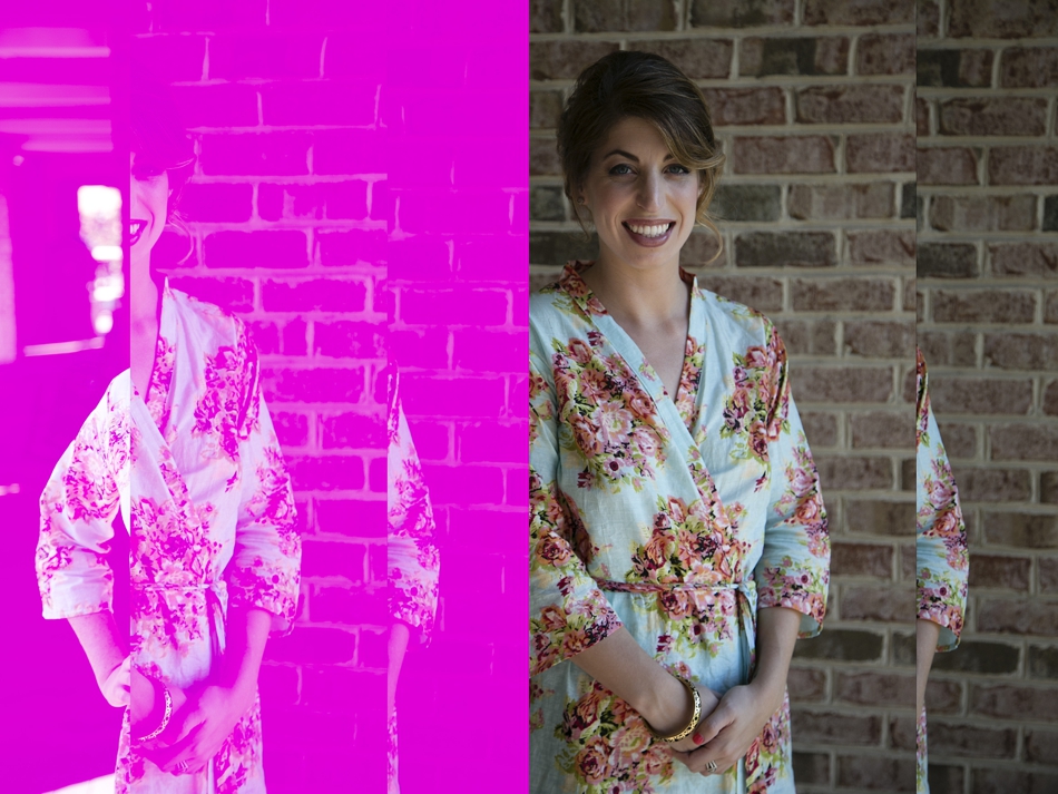

Hi All, I hope someone can help me with this. Here's the problem and see the photo for what it looks like
Shot in RAW on a Sandisk 32GB CF card 90MB/s AND a Sandisk 64MB Extreme Pro SD card - Raw as well
Both gave me the same two corrupted files, one after the other.
It looks this way in camera before I uploaded to my Mac AND it happened the same on both cards so the card reader can be ruled out. I also used to different card readers to upload.
Both cards were formatted in Camera.
Has anyone had this problem? I don't want it to happen again on a more critical shot.
Thanks in advance,
Echard

Have you tried low level format or with a different card?
09-30-2014 11:47 AM
No, I've not tried that.
09-30-2014 12:00 PM
Are both cards written simultaneously, or is the image written to the primary card, then copied to the secondary card? If the latter, then only one bad card is required to explain it. Two bad cards, of different types, is pretty far-fetched. (BTW, under that scenario, if you reverse the primary and the secondary, the problem should go away - or at least be confined to one card.)
One thing you might as well do, before you send the camera and the cards to Canon, is to make sure that you have the latest 5D3 firmware (1.2.3) installed. But that's pretty far-fetched too.
Actually, I have seen that phenomenon before, though not recently and not on a 5D3. As I recall, I never did figure out what corrupted the files.
09-30-2014 12:16 PM
Thanks Robert. I am using the record seperately option. Both shooting raw. I don't think one card or the other is primary in that option. Correct me if I'm wrong. I do have the latest firmware update.
Is this something Canon CAN fix? IF I send in the camera and card?
Echard
09-30-2014 02:00 PM
If there is something wrong with the camera, otherwise, they'll not fix it if it is a card issue. Also, they will not restore your images. So I don't see a point of sending the camera in unless you're pretty certain that it is the camera problem. You should try to do low level format, go out shoot random things, and test it. Then go out and buy another card to test too. I think you have a better chance of return the card to Sandisk and get a new one. They have Limited Lifetime warranty. I have done it once. You can go here for more info: http://kb.sandisk.com/app/answers/detail/a_id/5232/~/return-material-authorization-%28rma%29-process
