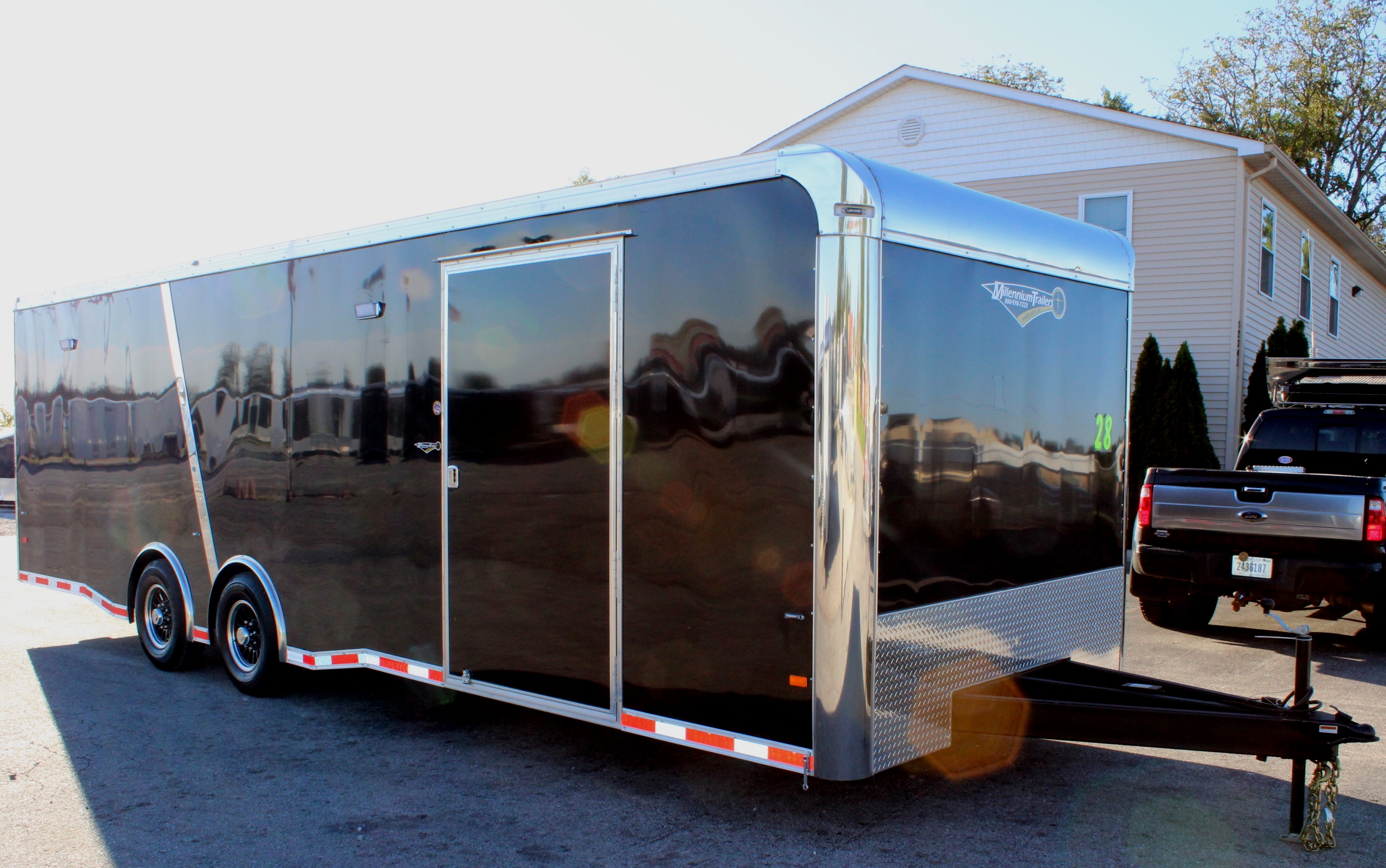

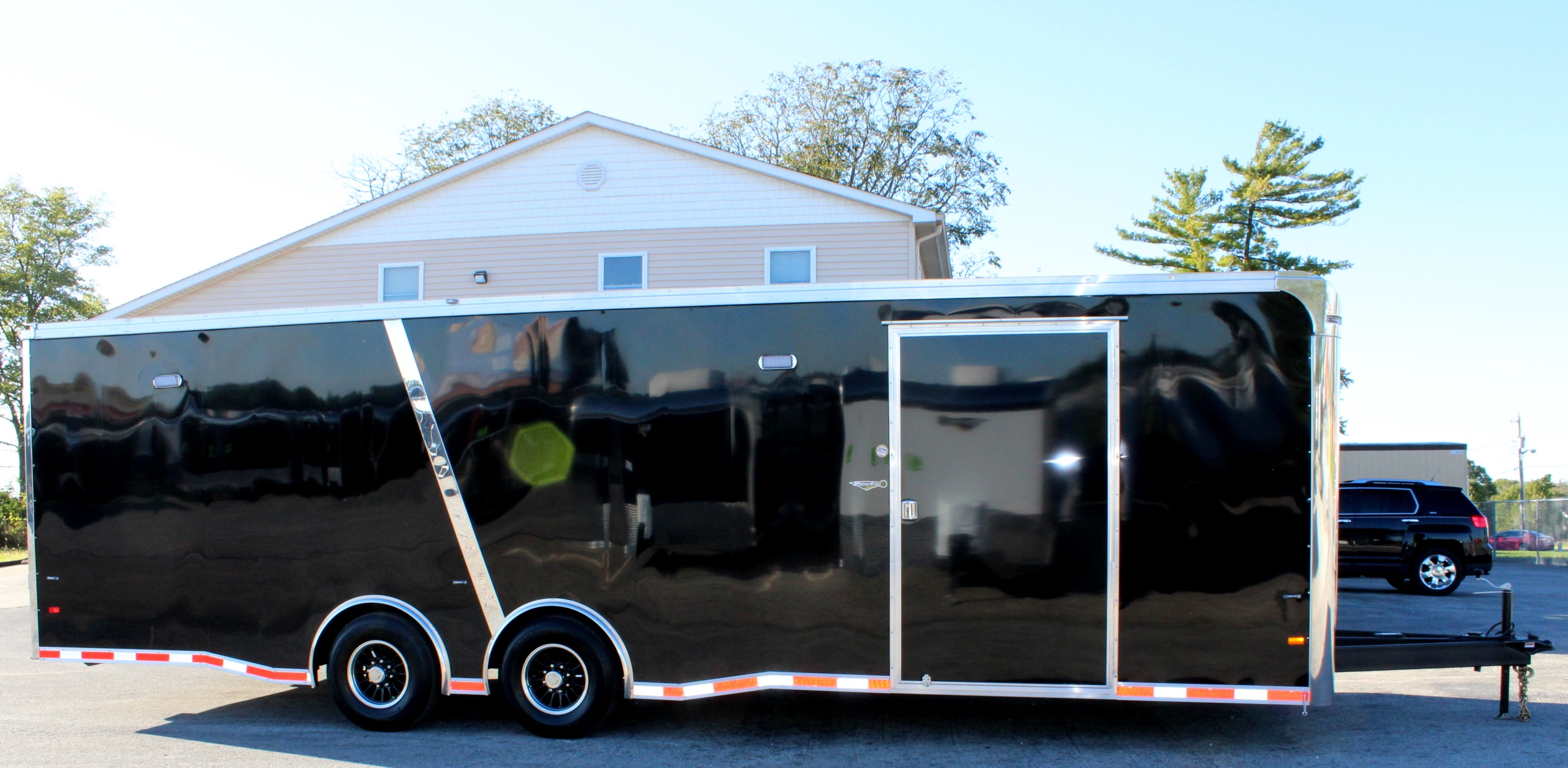

Yes, kind of although they are usually a more defined hexagon in green, gold, red (some are large, some are small) and on one pictures it could have multiple colors and sizes, some are overlapping etc. I was trying to paste an example but it won't accept the picture.

@Sharonind1279 wrote:Yes, kind of although they are usually a more defined hexagon in green, gold, red (some are large, some are small) and on one pictures it could have multiple colors and sizes, some are overlapping etc. I was trying to paste an example but it won't accept the picture.
Post a sample photo.

Yep, those are definitely lens flare.
You might be able to reduce it by...
1. If you don't already have it, get and use the correct hood for your lens.
2. If you have any filters on the lens, remove them.
3. If you must use a filter for some purpose (such as ploarization), be sure it's high quality, multi-coated,...But still only use filters when they serve a purpose. Added layers of glass give more surfaces for flare to reflect..
4. Watch for flare occuring in your viewfinder and slightly reposition yourself and/or the camera & lens to reduce it.
5. Generally be aware of the position of the sun and try to avoid shooting directly at it. In other words, keep the sun behind you as best you can (in both your examples, shooting at a different time of day would have solved the problem).
6. Any strong light source that's directly striking the glass elements of a lens can cause flare effects. It's not limited to the sun alone.
As Tim noted, some people actually incorporate various types of lens flare deliberately in their images. In fact, there are image editing software that ADD flare to images.
A different lens might be less prone to flare... But all lenses do it to some degree or another. Below were shot with very high quality Canon EF 24-70mm f/2.8L lens (with it's lens hood and without any filter). To reduce the flare in the second image, the only difference was was moving camera and lens slightly. It was easy to see in advance in the viewfinder,, what the difference would be in the images.
