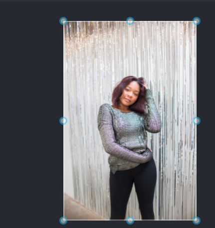

for refference here is the issue in question. Everything abou this looks off to me. the sweater is a pale gold in real life.
here is the exact same spot shot with the 70d. Someone please help!

I cannot judge the differences objectively, mainly because the photos and clothing are a little too different. They appear to be very similar, but very different shots, taken with different cameras. Was the same lens and lighting used? I assume it was.
The backgrounds seem similar, but there are easily noticeable differences. It is hard to evaluate any differences because the angle of views are too different, and the backgrounds are so reflective.
As for the item of clothing that has the wrong color, how were the posted images created? The fist shot appears to look like a screenshot, instead of a crop of an actual photo. A screenshot introduces distortions unrelated to the camera.
You also report the problems show up after saving. Do you mean the RAW files are clean, but the issues do not appear until you export to a JPEG? If so, this could be a sign of too much adjustment to one or more settings in post processing.

Was this Mk III new or used? It looks like the AAF might have been tapered with. What lens?
