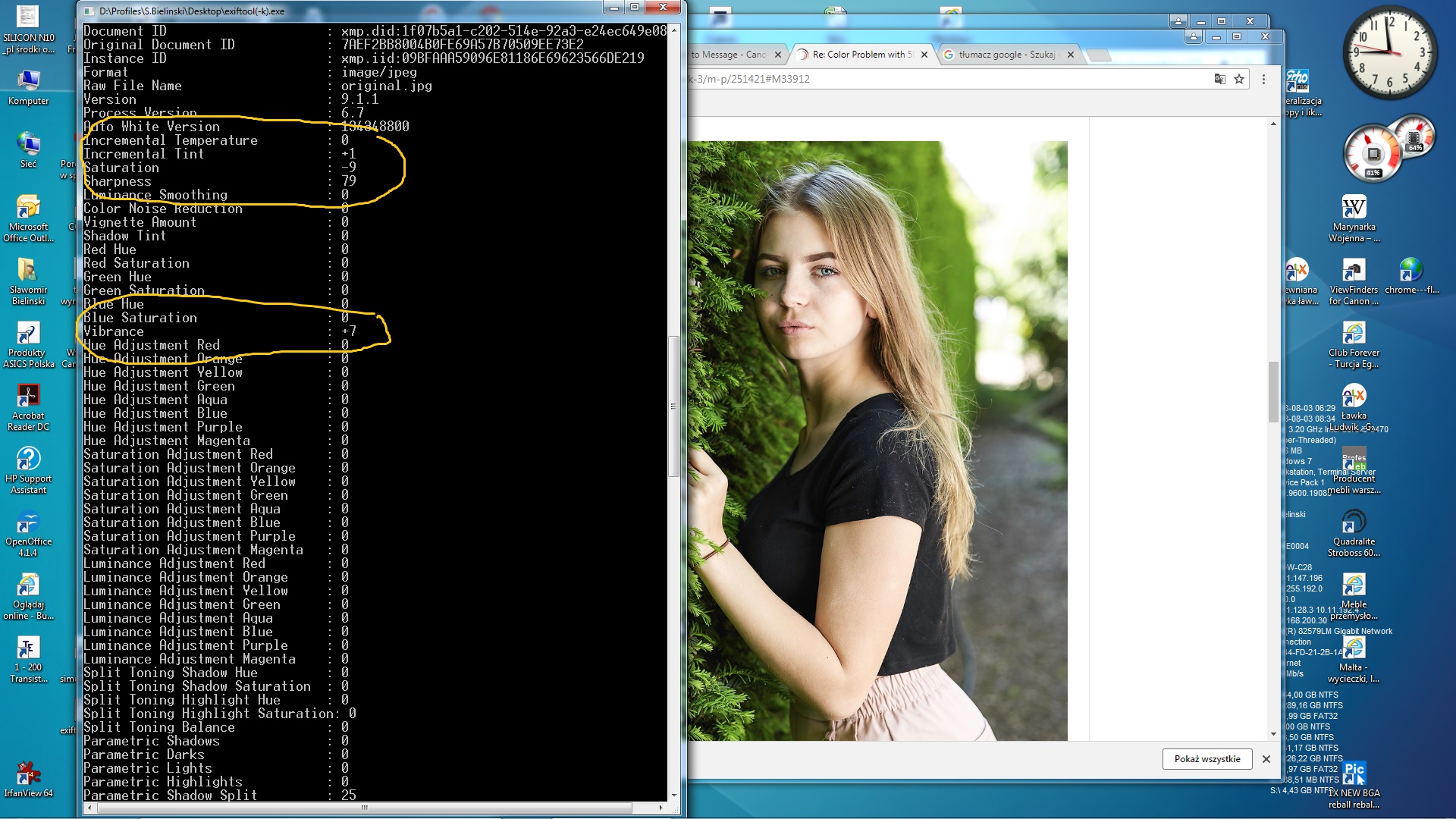

I opened your jpg in ACR not LR and didn't make any additional edits except WB by selecting different areas.  Look at the gravel right to the right of her back.  There are several spots that are petty close to 18% gray.  Choosing her shorts was a mistake so don't choose areas like that anymore.
You are probably unconscious of it here is the proof that sliders in ACR was moved and tweaked
settings 1
settings 2
Thanks a lot to you all. You give me a bunch of very usefull information that I will use in my workflow.
My display is HP Elite Display E243i quite a good one but not for the commercial graphic work. I must finally to invest some day in better display but not now. And I will do calibrate my display to see a difference.
You've also confirmed me that everything is fine with my camera and I need to work on my post processing skil yet.
