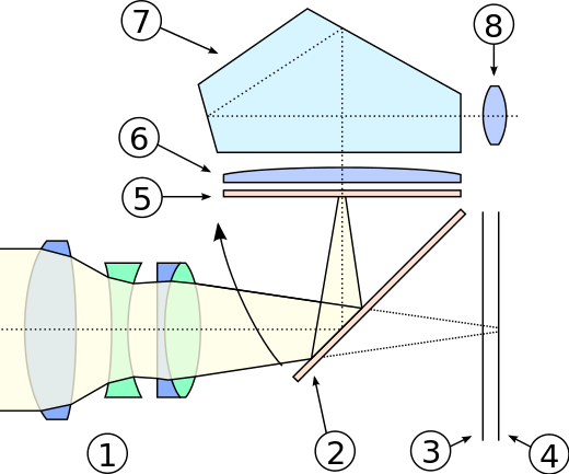

A DSLR uses different AF hardware for shooting stills vs shooting video or Live View.  The AF system for video and Live View is much slower to auto-focus.
When you shoot stills, the AF sensor is located at the bottom of the mirror box.  The mirror reflects light downward toward the AF sensor and upward toward the OVF, Optical View Finder.
When you use Live View or record video, the mirror swings up and out of the way.  The image sensor is used BOTH for image capture and auto-focusing.
If the camera is capturing video, there is only a very brief moment between video frames for refocusing.  It is insufficient time to perform an accurate focus under all scenarios.
I have no idea how Dual Pixel AF actually works.  There are actually two light sensing elements comprising each pixel.  One pixel could be dedicated to image capture, while the other pixel could be dedicated to auto focusing during each frame, instead of between frames.
