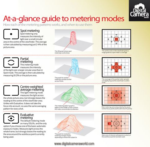

Metering has several different options, of which the default is Evaluative, which considers the majority of the Field of View and finds a compromise value of prioritization.  To get this under control, one may have to move about the focus point, which takes time and is imprecise.
While this works for many scenes, it is not good where there is a lot of contrast and the subject is in bright light, as in the following image.  In evaluative metering the system would have considered the dominant black area, thus blowing out the actual subject.

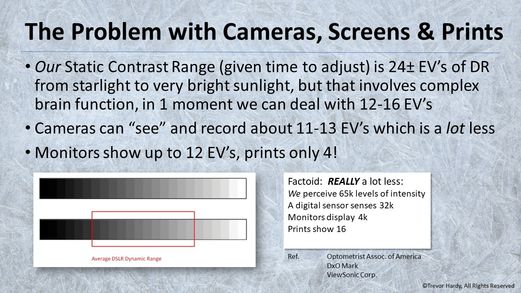

One solution to both issues it to be very precise with what is metered.  To do so, one must understand that a camera's dynamic range (the capacity to include white to black and all shades in between) is much less than ours.  So what we see (mediated by a lot of brain activity) will be much better than what the camera can capture.
What the sensor tries to do is configure the exposure settings for a reflectance level of mid-grey (aka 18% grey) - because colour is irrelevant in reflectance.   So, the more precisely one can specify the correct level of reflectance, the more correct that exposure will be achieved and this is done by being more specific in what is metered - which is where we come to the metering modes.
I personally prefer to shoot in single point, centred metering, and lock with the * button on the back of the camera.  I combine that with Back Button Focus, (assigned to the AF-ON button) which allows me to define exactly what point in the photo is the focal point.  This is critical for photographing people or animals, where the eye is the critical. element.

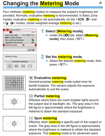

Setting up Centre Point or Spot Metering: In either camera, via the menu, one can set the centre point metering as per the following from the SL3 manual:
