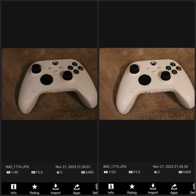

As far as photos, all I really have is the attached, very poor, photos. I just wanted to see how much the settings were changing in Auto in one mode to the next, so I took some photos of my controller in my lap, in my darkened living room.
The photo on the left is from Live View. You can see that the camera chose a 1/40 shutter speed. This image looks *exactly* like the dimly lit controller did in real life. The left photo was taken immediately after, using the viewfinder. The camera selected 1/25 shutter speed, which made the controller look significantly brighter than in real life.
Obviously these are extremely poor photos, and I can take some better ones later if it would help. But I noticed this issue late at night and started fumbling around with it long after the sun had set!

Whenever something like this happens the best next step is to reset the camera(s) back to Canon default settings.
Menus>Tools>Clear all settings and also Clear all custom settings. This puts you back to square one a basic start up. Now try and see if it still happens. Next a brand new SD card forma a top manufacturer. Make sure the batteries are fully charged.
It is unlikely that two cameras would exhibit a problem that is identical so user error is a high probability. Do the reset and see what happens. In case it doesn't help you may need Canon to service the camera(s). 1 (800) 652-2666
