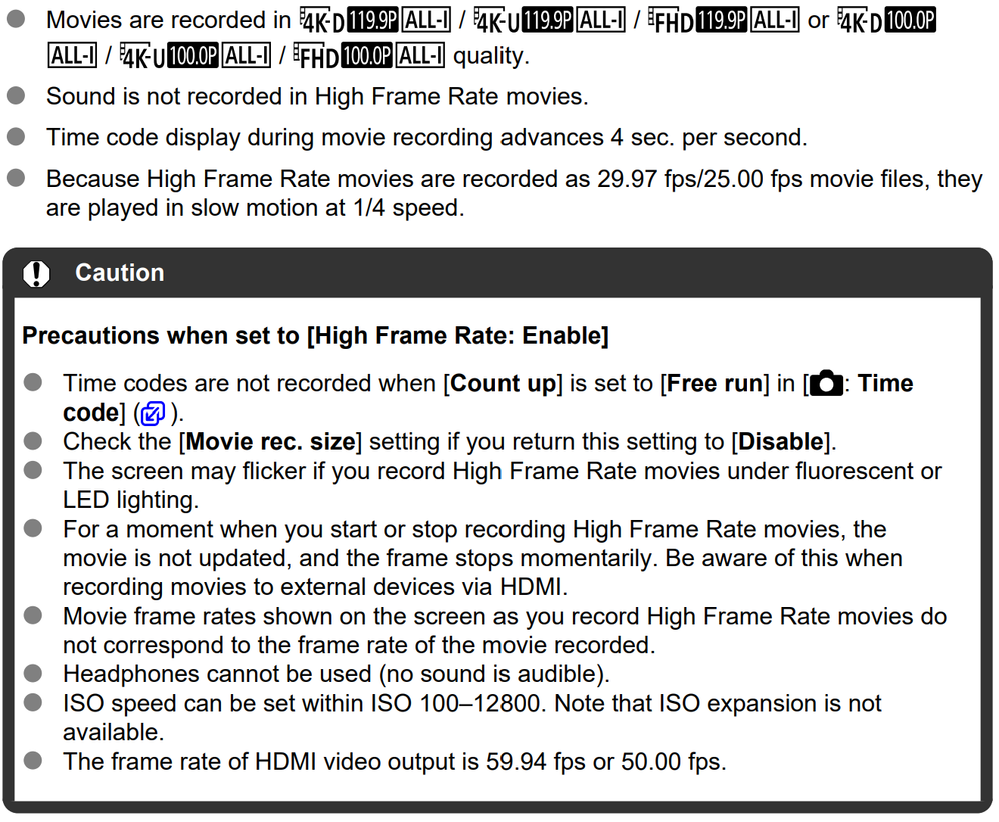

What you're seeing is NOT a problem the camera is working as designed. The camera manual highlights this restriction. The camera will save the frame rate as 29.97 fps for NTSC/ ATSC video & 25 fps for PAL/ Secam video.
-Demetrius

This isn't correct.  Brittany isn't recording in any of the shown high-frame rates (100 fps or higher).

This is the closest explanation I can find. Unless there other limitations on a different page. For instance movie cropping.
