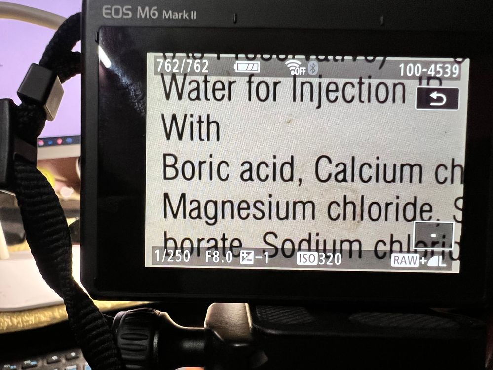

I am comparing the 10x zoomed versions of the pre and post shot views on the camera's LCD screen display. the image is sharp in pre click view but the sharpness is deteriorated in post click view.
Here are the two images using  EF-M 32mm f/1.4 STM lense. The first image is before clicking and the second image is after clicking.

I am not seeing a problem. Looks normal to me.
