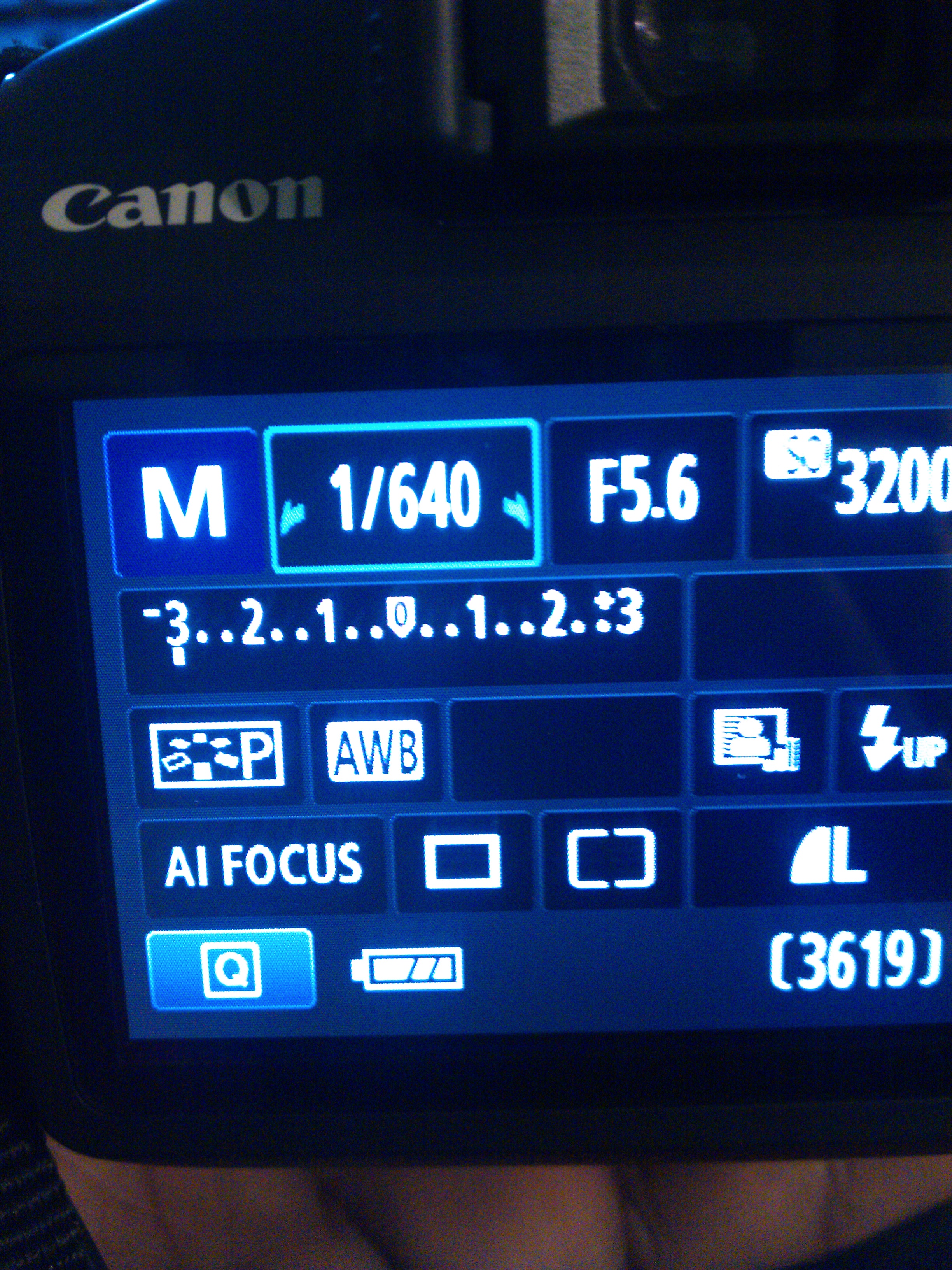

I have attached a photo to illustrate wheni hit on the shutter button do you see under the minus 3 where the comp is located. I cant recall but it suppose to be at 0. I dont know how it got there, I tried changing it but I was unsuccessfully.
Also you can see my batter is fully and the SD card can take alot of pictures as the image illustrate.

When you have your camera in Manual mode, the -3 means you have the camera set to underexpose by 3 (or more) stops. This can give you a black photo. You should not use Manual mode until you better understand the relationship between Aperture, Shutter Speed, and ISO. I would recommend using Program mode or Av or Tv mode.

I am going to try and change the exposure to not underexpose to be be normal. I usually shoot in Manual since i have freedom of my shoots. I have perfected in shoot in this mode, but what are the odds.
So i tried shooting on Program mode and its working perfect, I come to the conclusion that my manual mode is screwed up. I did however had my brother use my camera a day but i was present, now i have to backtrack and see what he did in Maunal mode. Thank very much for helpingme out,

In the Auto modes, the camera will try to center the exposure meter for you. You can over ride it and set - or + exposure compensation to lighten or darken the image.
In Manual mode it is up to you to select the aperture, shutter speed and ISO to get the meter in the center. If you can't get the meter near the center, then it is simply too dark.
