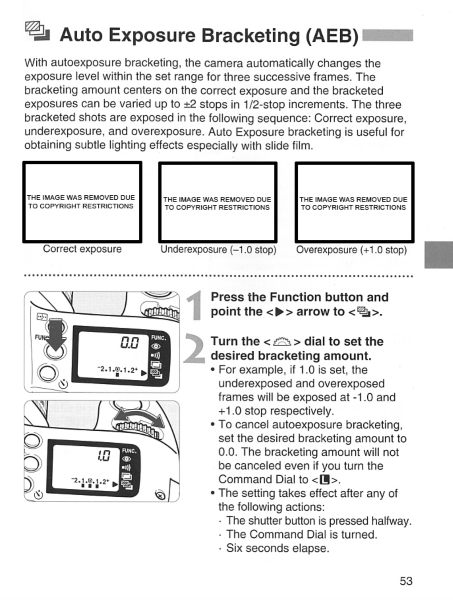

I have been shooting film on a Canon EOS Rebel 2000 for a few weeks now. Ive grown rather fond of using the AV, so the shutter speed is already set for me. Today my camera is now setting shutter speeds for 3 seconds rather than 1/200. i would just relocate to the manual settings but the AEB is at -2 when shooting from there and i have no idea how to change it.

Please check out the link below where you should be able to download your camera's user manual. It should help you to learn how to adjust your camera's settings.

Cancel Auto Exposure Bracketing by setting it to "0". That might fix your problem. But long shutter speed exposure times in Av mode may also mean it is not very bright where you are shooting and you need more light.
