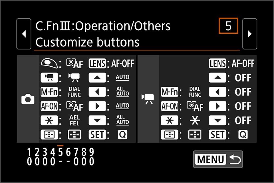

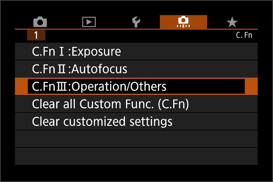

Firstly which mode are you using? If it's P, Tv, Av, M, B, Fv, C1, C2 then its possible that a custom control setting has been used to reconfigure the shutter button half-press to only meter, not focus. Does pressing and holding the AF-ON button make the camera focus?
If the AF-ON button works, then your camera is configured for "back button focus" to return it to regular focus with the shutter button. Press MENU, navigate to the C.Fn section then choose the third entry Operation / Others. Finally choose the fifth setting Custom controls, select the shutter button and change it to be Metering and AF start as shown.
