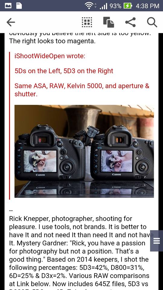

Canon EOS 6D has problem with yellow tint lcd, i can't custom WB with lcd, when i see the image on lcd is warm but when i shooted and preview on macbook or iphone, this became blue than the lcd, what happened with my lcd, i bought it 2 week ago in Vietnam, i compared it with another 6D and my camera 6D is more yellow tint than another. Who can help me dicuss about it and how to fix theme? I feel sad now because it bought from my salary and i am a student in college! I search on Google and the image same my problem, my camera same with 5DSR.

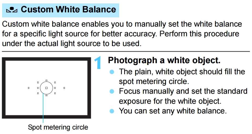

@pcstar wrote:When i took photo in Raw, everything is simple but when i can't custom WB when i use live screen to record video because it more yellow tint
You can set your camera's custom white balance with a grey card before you begin shooting video. See page 121 of the 6D instruction manual.
03-06-2017 06:03 PM
OK, these are iPhone photos of the camera next to the images in Lightroom with no adjustments, so it may not be as clear to you as it is to me when viewing images live or entirely scientific. Other than that, I can tell you I'm not making this up. Sorry for the site auto-rotating my square images.
03-06-2017 06:12 PM
@Brownjw wrote:OK, these are iPhone photos of the camera next to the images in Lightroom with no adjustments, so it may not be as clear to you as it is to me when viewing images live or entirely scientific. Other than that, I can tell you I'm not making this up. Sorry for the site auto-rotating my square images.
You might be comparing apples to oranges. First and foremost, the camera's LCD is not an accurate calibrated display. I don't see anything really wrong with your posted images. Turn up the brightness on the camera LCD, and the difference between the LCD and monitor might be reduced.
Speaking of the monitor. Has it been color calibrated? No matter. Even if it has been color calibrated, you would be comparing a calibrated dispaly to one that is not.
