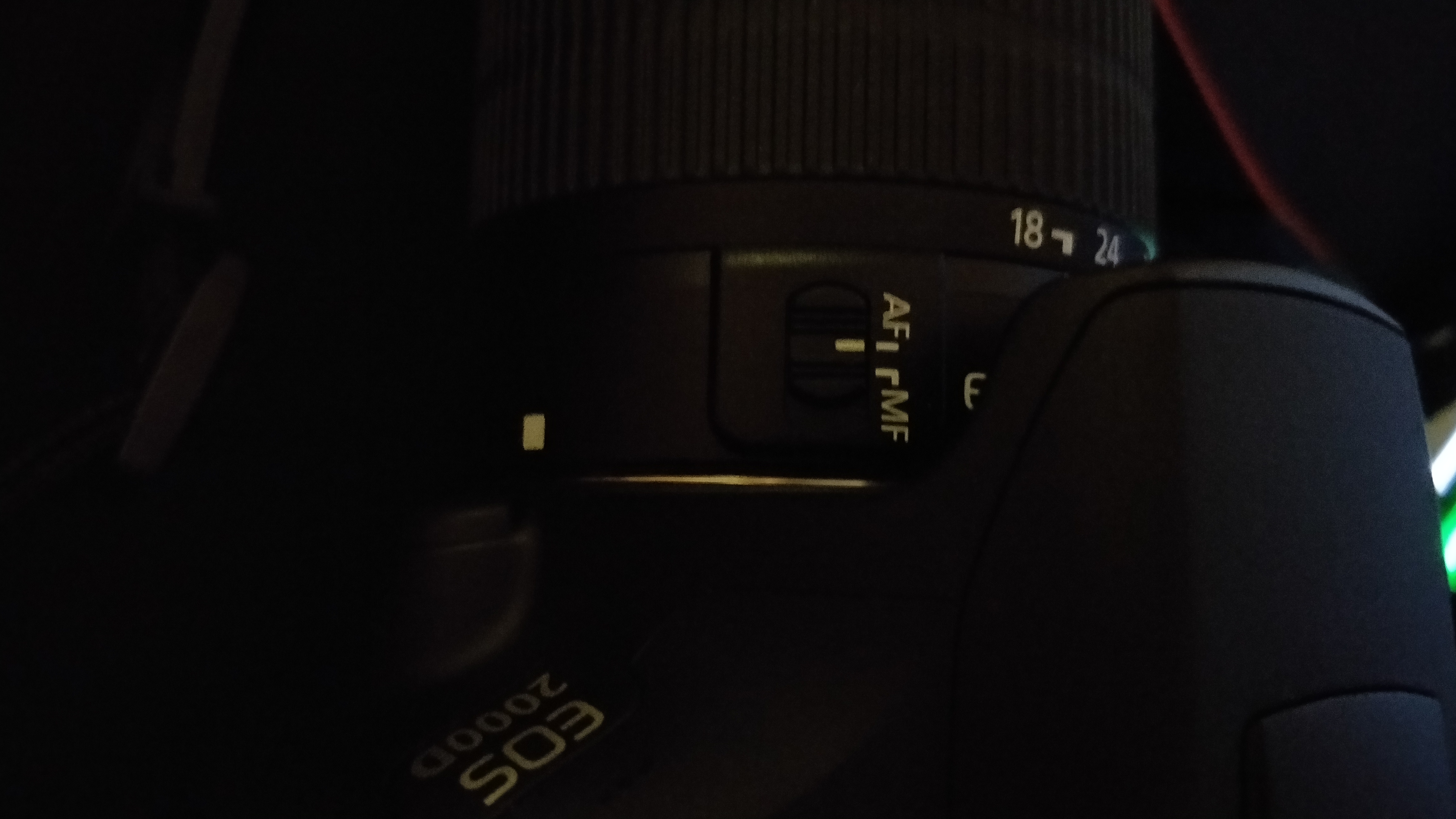

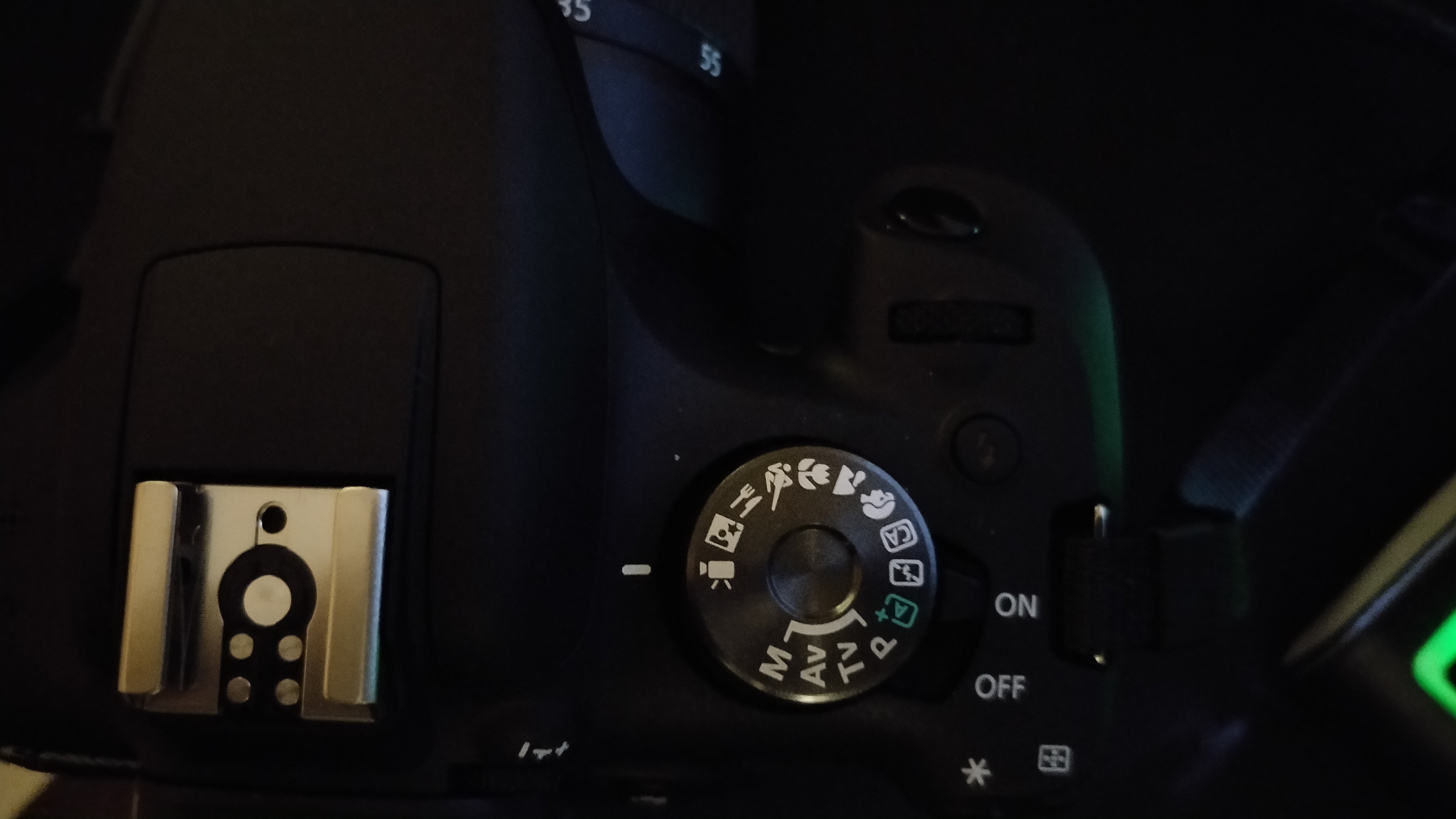

I have Canon EOS 2000D and i set too camera mode, AF method in Live mode.
I set the canon lens in AF mode and i connect the hdmi cable.
I have disable the auto power off.
I have video output to to my blackmagic mini and the screen on camera is off.
But after 30 min i got a message in hdmi outpout to press camera key.
After doing that i have again video outpout.
It's like camera go to hybernate mode.
How could bypass this limit?
I use camera for liver streaming.
