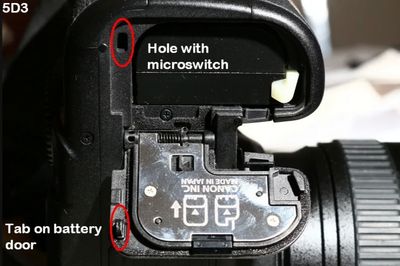

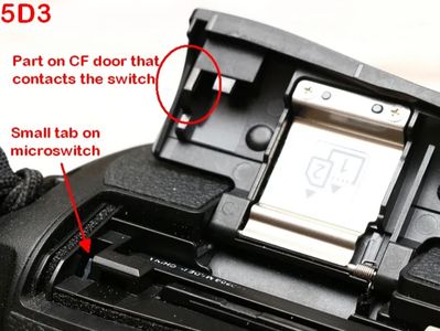

11-22-2022 04:56 PM - edited 11-22-2022 07:49 PM
Your camera may be a little different, but this is what they look like on a 5D Mk III.
All you can really do is check that the switches are intact, and that hey are making contact when the door is closed.
