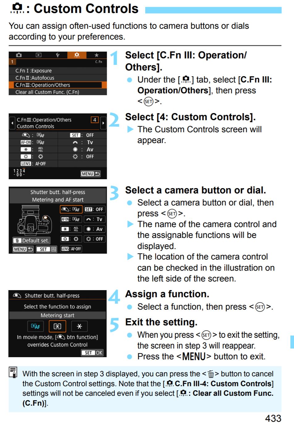

@nav16 wrote:Just to be clear. When I hold the af-on button then the squares will light up. But before when I hold the shutter button half way then it would light up and now they don't. I want the focus to happen when I hold the shutter button half way.. I can get the squares to go red and focus when I click the af-on but I want them to come on when I click the shutter button half way
First, check these two options to make sure you didn't inadvertently disable the red dot display:
If you have correctly set the above options and still have the problem -- If you can light up using the AF-On button and not the shutter button then there's a chance that you have inadvertently turn off the AF for the shutter button. Is the camera focusing when you press the shutter button half-way?
Check this option: Make sure the Shutter Button (first one) is set to AF
