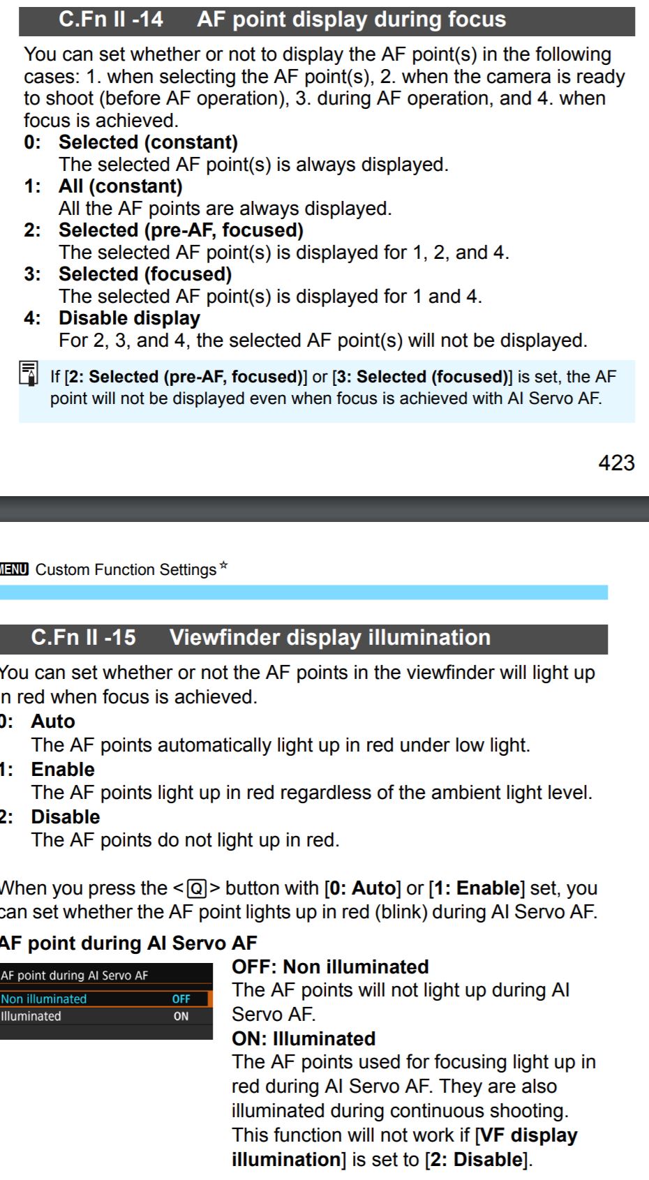

First, check these two options to make sure you didn't inadvertently disable the red dot display:
If you have correctly set the above options and still have the problem -- If you can light up using the AF-On button and not the shutter button then there's a chance that you have inadvertently turn off the AF for the shutter button.  Is the camera focusing when you press the shutter button half-way?
Check this option:  Make sure the Shutter Button (first one) is set to AF
