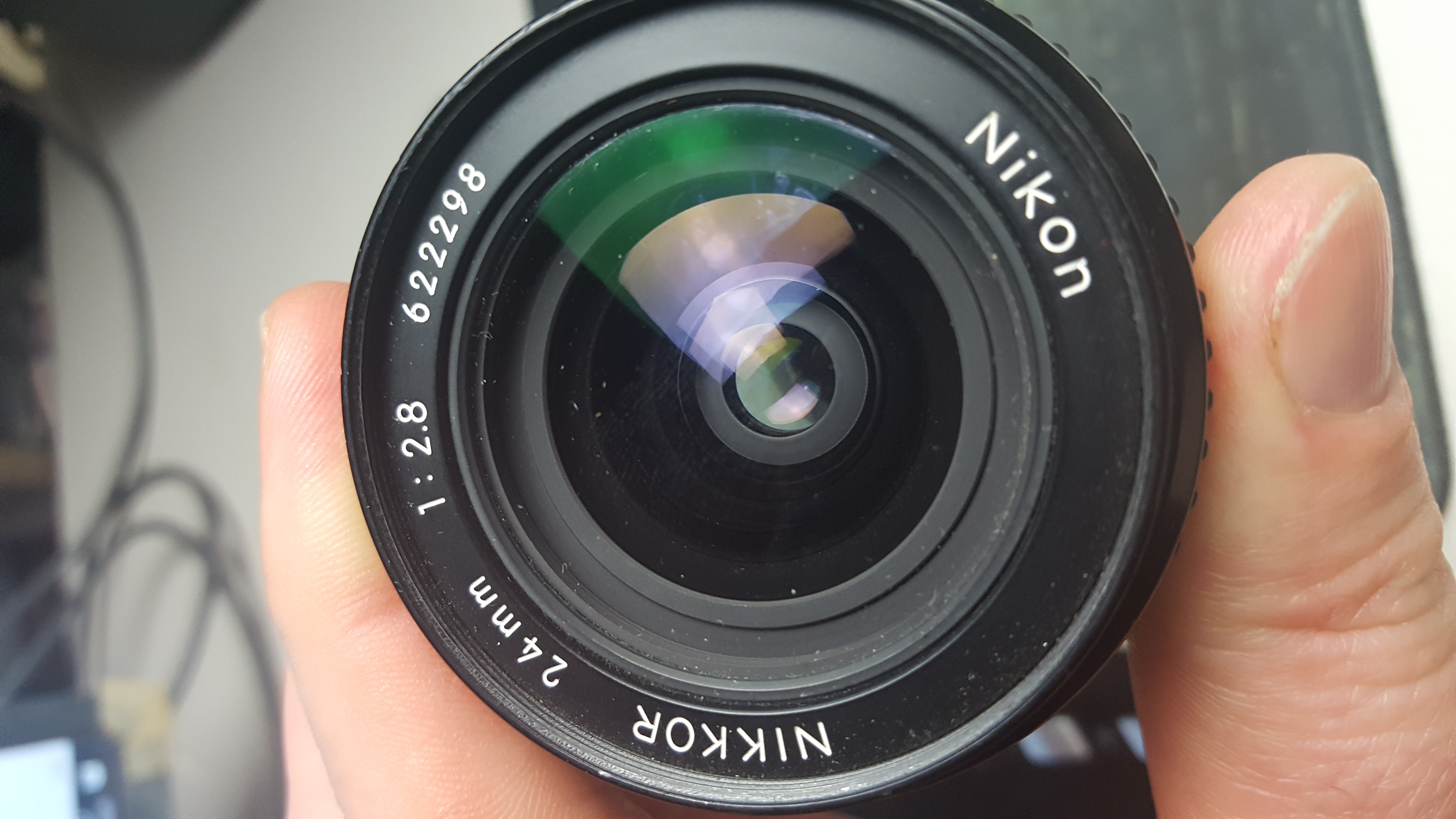

It's an FT series lens Nikon, and a generic adaptor.

12-15-2020 10:05 PM - edited 12-15-2020 10:09 PM
I have never heard of a FT series lens. Do you mean an F mount lens from a Nikkormat FT camera?
Can you show us a photo of the lens and adapter?
Canon auto exposure lenses don't create or cause flicker. Have you tried using a Canon EF lens?
A simple Nikon to Canon adapter should have no electrical contacts and no communication with the camera. I can't think of any reason why you should get an Error 1 with a simple adapter.
12-15-2020 10:45 PM
12-15-2020 11:07 PM - edited 12-15-2020 11:10 PM
Your adapter has electrical contacts on it for an AF confirm chip. Some AF confirm chips will cause errors with some Canon DSLRs. That is probably causing the error.
Either tape over the contacts or remove the AF confirm chip, and I bet the error goes away.
