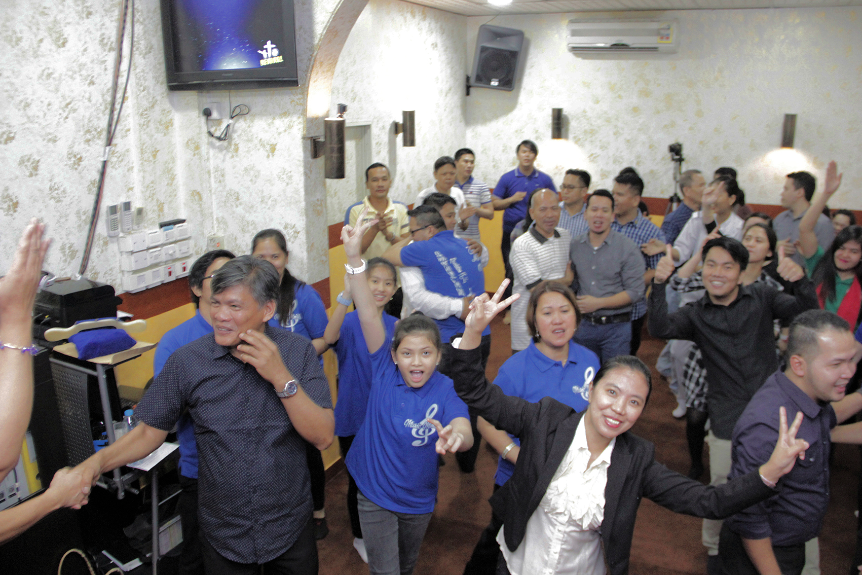

Everytime i took photos on my canon 600d white fill always appear, i tried resetting everyting and changing everything but no to avail success, googling also i tried but no sucess any ideas?

I think you will need to tell us a lot more information about exposure & lighting details before anyone can really make a proper judgement about this.
It would make more sense to call it low contrast rather than white fill.
well TBH .. the the camera has performing very well before.. until one day all of my shots (which has proper lighting and exposure) have always a white fill on the resulting images .. call it low contrast or whatever .. i;ve done everything, reseting the white balance, tried every white balance, picture profile always bears the same result
After a second look at this I copied it into my photo software and can see from the histogram that it is extremely over exposed, this can mean any one of the following
1. you have the camera incorrectly set
2. you have an external flash incorrectly set
3. the camera has a fault
4. the lens has a fault.
Try to give us an outdoor shot in normal daylight without flash.
I have attempted to correct your photo but it is really too bad to put right properly.

Thanks man.. i tried daylight shots and still the i will be uploading it soon, maybe its about the I hit the canon center, its quite odd really,
1. you have the camera incorrectly set (I always set correctly)
2. you have an external flash incorrectly set (external flash is not equipped)
3. the camera has a fault (this is the one suspect) 😞
4. the lens has a fault. (nope all my lens are good, tried it on some of my canon body)
