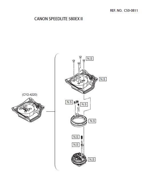

The 580EX II does work with the 5D III. But there is a known issue with the 580EX II whereby the foot can come loose and not make good contact. It's easily remedied and Canon even has a service to upgrade the foot to one not prone to have this issue.
With the flash off the camera, try wiggling (gently) the plate on the foot. It should be solid and not want to wiggle. If it does wiggle... it's loose.
Tightening it requires a bit of disassembly (not too much) of the flash and you may want to send it to Canon service.

The loose foot plate is a fairly common issue (and easily fixed).
But also keep in mind that there are 5 metal contact pins on the foot of the flash and these mate with the 5 pins on the camera hot-shoe. The 6th contact is the hot-shoe itself (the metal foot plate is actually the ground contact and it mates with the rails on the camera hot-shoe to provide the ground connection.)
Those 5 pins are spring-loaded. If you push them with your finger tips, they should push in and spring back out when you release them. If a piece of dirt manages to get widged into the pin, then it might keep it from springing back out properly and prevent it from making a good connection to the camera. If this happens, the camera may believe it does not have an ETTL flash connected. The pins would need to be cleaned (Do not oil them... that would only attract more dirt. The pins have a loose fit that requires no lubricant. Just clean out whatever dirt may be present if the pins are not performing as they should).

If you are still experiencing problems, take a look at the pins on your hotshoe. Older 430EX II and 580EX II had rounded pins which can sometimes cause problems. Canon changed these pins and now all their flashes haves "pointy" pins.
If your flash is still on warranty, Canon can replace the entire foot with one that has the "pointy" pins.
I don't have a problem with mine but I called Canon Canon about my 5 year old 580EX II. They won't repair it for free, but they can sell me a replacement part. The old Canon part number is CY2-4220, but the new "Pointy Contact" replacement part is CY2-4220-020
