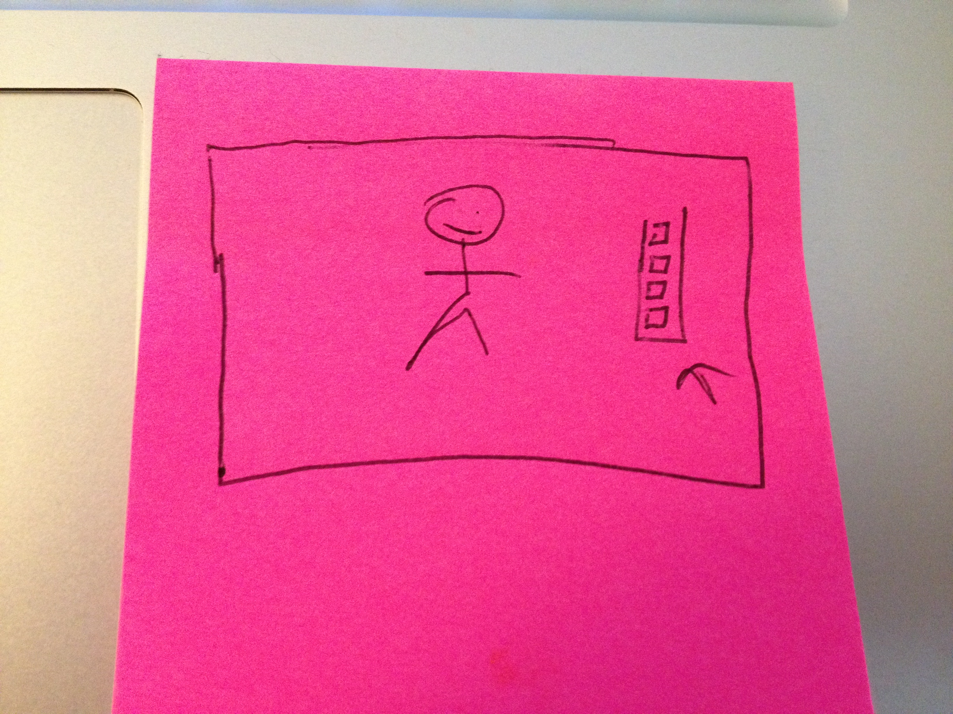

I was shooting on my new Canon 5d Mark iii yesterday, recording to a 16SD card and using a RODE shotgun mic for sound when a weird image appeared on my live view. Towards the right of the screen these blocks started piling up. When there were 4 blocks, my video stopped recording! I'm talking maybe 10 or 15 second videos here. My SD was less than half full at the time, and when I hit record again I only got about 10 to 15 seconds more of video recording. What the heck was going on!? Please help!
I've drawn a picture of what the blocks lookied like to further illustrate my point. Thank you!

if you are recording video to the sd card slot, the canon 5d mark3 will shut off because the the sd slot cannot write video to an sd card fast enough; the sd card slot was never designed to record video or even photos. if you try to record video to the sd card, it will start recording, but when the buffer fills up, the camera will stop recording. even if you have a super fast sd card, the 5D will still stop recording when recording video; Canon did not design the sd card slot to record video (unfortunately). record video to the compact flash card, select the appropriate card slot. class10 udma7 / 800x / 120Mb/s is plenty fast for recording 1080p video on the 5D.

your camera is probably fine, just record video to the cf card. record video to the compact flash card slot. change the record to in the yellow menu system. the sd card slot is not fast enough to record video, it does not matter how fast your sd card is, the camera cannot write video data fast enough to the sd card. i talked to canon, they told me the sd card slot was only intended for firmware updates, not to write data such as video or even photos. however, i have used the sd card slot for photos, but am sure to pause between each click to allow the camera to write to the card; when the red light turns off, i take another photo. most of the time i use the compact flash card slot for everything. cf cards are more expensive, but they are more reliable and more shock resistant than sd cards. unfortunately, the new canon 5d mark iv has the same slow sd card slot. after 4 years, i would have expected dual cf card slots plus a writeable sd card slot.
