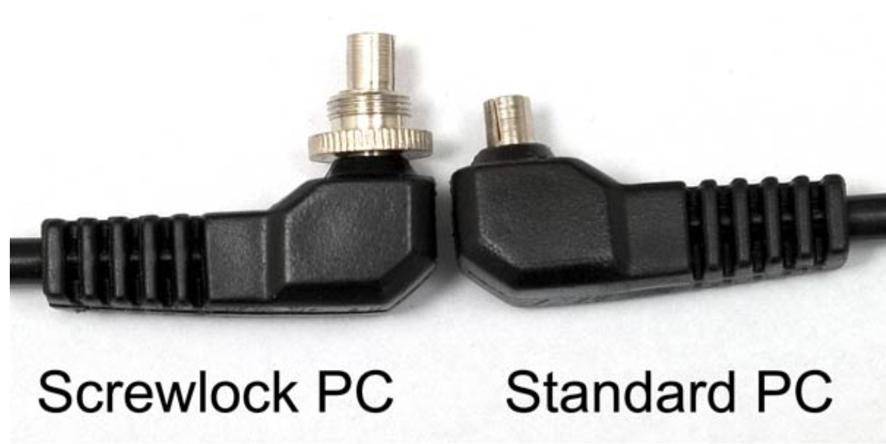

has a cable that on one side looks like a typical headphone jack, the other side of the same short cable is a stubby, round end, that has a metal tab dead center inside the circle. Now this side doesnt seem to fit into anything on my Canon.

The other cable is used for a PC terminal. In this case PC means Prontor-Compur not Personal Computer.
https://en.m.wikipedia.org/wiki/Prontor-Compur
“A Prontor-Compur connection (also known as a PC connector, PC terminal, or PC socket) is a standard 3.5 mm (1/8") electrical connector (as defined in ISO 519[1]) used in photography for flash synchronization.”
This is an older type of connection first used in the 1950’s. It is not used as much these days, but still present on most high end, or professional cameras, and some flash units.
They were not held in very securely so a more recent development was the Screwlock PC terminal which must be screwed in for a more secure connection.
