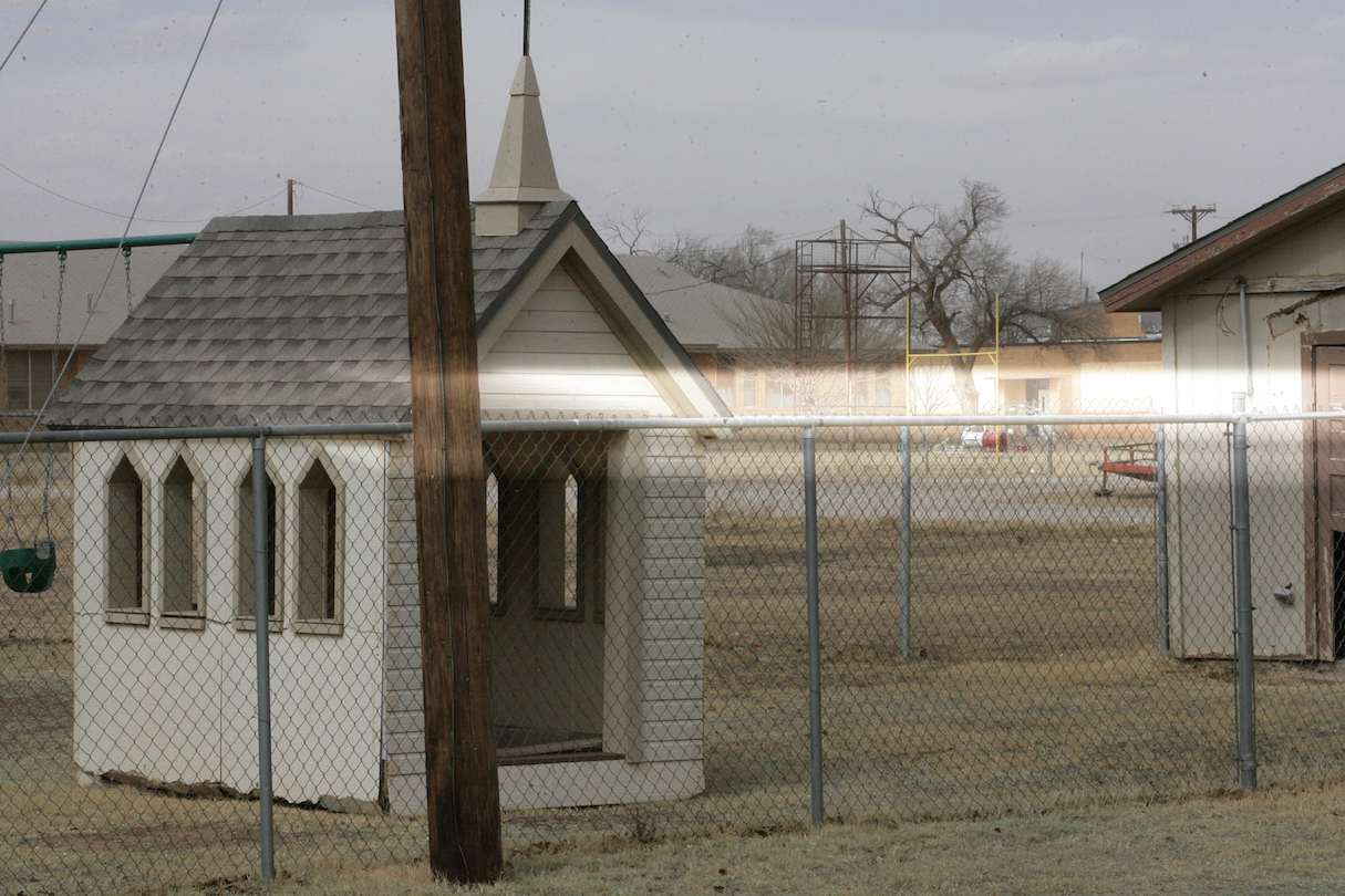

Hello. I'm new to the forum but no to Canon.
I picked up an old 1DIIN just to tinker with. It was sold cheap because of what looks like a senor issue. When pictures are taken wide open the white area in the picture occurs. When a lens is stopped way down it almost goes away and in some cases is gone completely.
Sensor problems most likely. Anyone seen this before and what is the solution?

Broken shutter.
Bob
how costly is that to fix?
Probably too old for Canon to still support, one of the aftermarket shops might do the repair.  But it will be more than the body is worth.

If you are into do it yourself you could buy one of the Chinese shutter assemblies on ebay in the $60 range and attempt to repair it yourself.  If the shutter went out on my old 1D2 AND I had access to a genuine Canon replacement I would probalby undertake the repair but I wouldn't go to that level of trouble to put in a likely counterfeit part that may not work at all and if it did it would likely have a short and imperfect life.

Call Midwest Camera Repair.  No biggie as shutters are not difficult to replace.  Estimate $350 give or take.

I got a couple of bids for fixing it but decided to sell it to a local guy who wanted to give it a shot for fixing.
