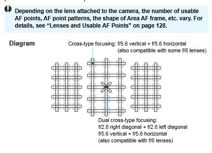

You need to be precise with the lens model and extender model.
If you have EF 100-400mm f/4.5-5.6L IS II USM and EF Extender 1.4x III then you will have cross type AF points with the central 9 AF points, plus horizontal line sensitive AF points in the blocks of 9 points either side of the centre group. In the manual this is group G.
For any other models of extender and the mark 1 "push-pull" lens then only the 1 AF point at the centre will be able to focus, this is Group H in the manual.

It’s complicated. The 80D shares a similar AF system used in the 90D and 6D2, which can support up to 27 f/8 AF points. Exactly how many varies from one lens to the next, combined with what version of the Canon teleconverter you are using.
The User Guide has tables to help you determine how many AF points will be enabled, which ones are enabled, and at what sensitivity.
Like I said it’s complicated.
08-23-2024 02:15 PM
Correct! It is complicated and confusing at first. But you still need to reference the charts.
I believe your Mark II lens will allow the full complement of 27 f/8 AF points to be enabled, but only with the Mark III version of the Canon 1.4x teleconverter. I believe the enabled points lose their “cross type “ behavior.
Performance with the original lens release just may be reduced to only the center AF point functioning in a degraded mode no matter which Canon teleconverter you use.
