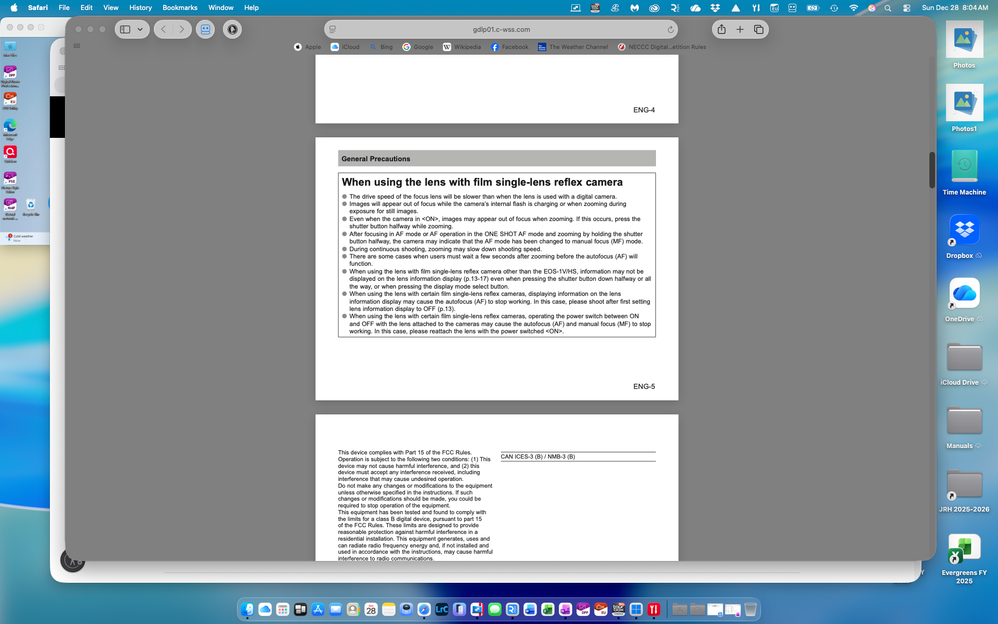

Maybe this will help:
https://gdlp01.c-wss.com/gds/3/0300025753/02/ef70-300f4-56isiiusm-im2-eng.pdf

Thanks for the quick replies. I could have thought of looking in the lens manual myself...
