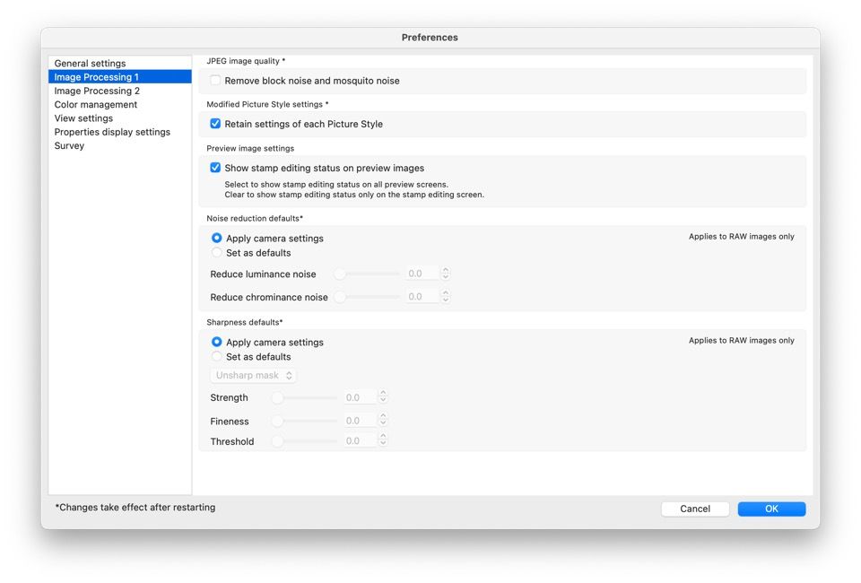

High ISO noise reduction is applied to images with higher ISO settings. For JPG, the processing is done by the DIGIC processor in the camera based on the settings standard, high or off. For RAW images the setting in the camera is saved as part of the metadata in the RAW image. DPP reads that setting from the RAW and applies appropriate levels of luminance and chrominance noise reduction depending on the ISO and the particular camera model. Simply setting high iso noise reduction to OFF in the camera does not result in zero noise reduction being applied in DPP when processing a RAW file.
In the DPP settings Image Processing1 the default is to apply camera settings, but you can change this to apply your own settings, including zero for both luminance and chrominance.
See the attached screenshots for the settings in DPP with the default and the manually set zero values.

With DPP set to "Apply camera settings" the expected behavior is for DPP to use the as shot camera settings, not to come up with its own. This is easily demonstrated by opening a RAW in DPP and comparing it to the straight out of camera JPEG of the same shot. They look identical.
That said, I'm not concerned about DPPs behavior because as you pointed out, I can always change the noise reduction values. I'm simply using DPP to confirm that the straight out of camera JPEG's do in fact have noise reduction applied even when High ISO speed NR is set to OFF in the camera. This is easily demonstrated by comparing the JPEG to the RAW in DPP, as above. They are identical. To further illustrate this, setting Reduce luminance noise and Reduce chrominance noise in DPP to 0 results in a significantly noisier image than the SOOC JPEG.
