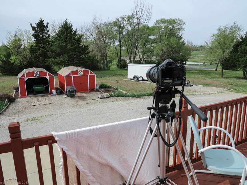

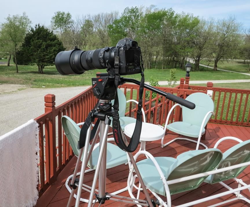

However, still wanting to use you Rebel XTi a good tripod and a telephoto lens is a better solution. You must be in a position where you can see your feeder otherwise how would you know when to trigger the Rebel so a tripod and tele lens is a good option.
03-26-2024 12:01 PM
Thank you, and those are great photos. I would prefer to see through the iPad what I'm going to take a photo of, if an app enables that.
