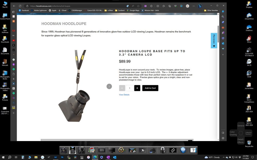

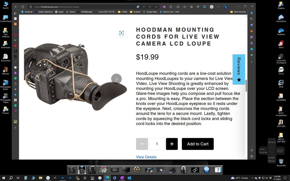

If you can't drive to a Canon repair facility I think the only quick "solution" is LiveView focusing. You can ake it less annoying and almost like viewfinder focusing by getting a Hoodman LCD loupe.
