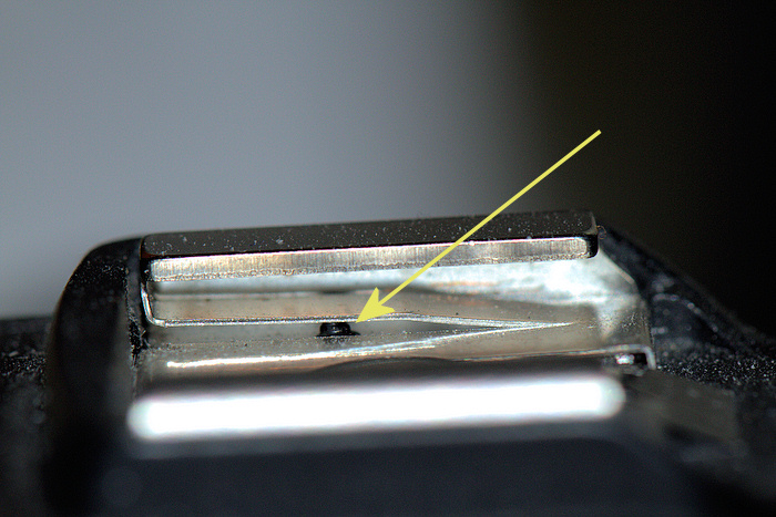

There is a small switch that senses if the camera has a flash attached.
Flash switch
It could be stuck down.
Tim
