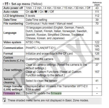

Thanks Lotus.  Do you know of a way to determine which version of Firmware is in my 30D?
Especially note the shaded box at the bottom

It looks like I have version 1.06
Looks like I have Version 1.06...great!! Thanks.
You too, could download the manual and search it for "Firmware".
