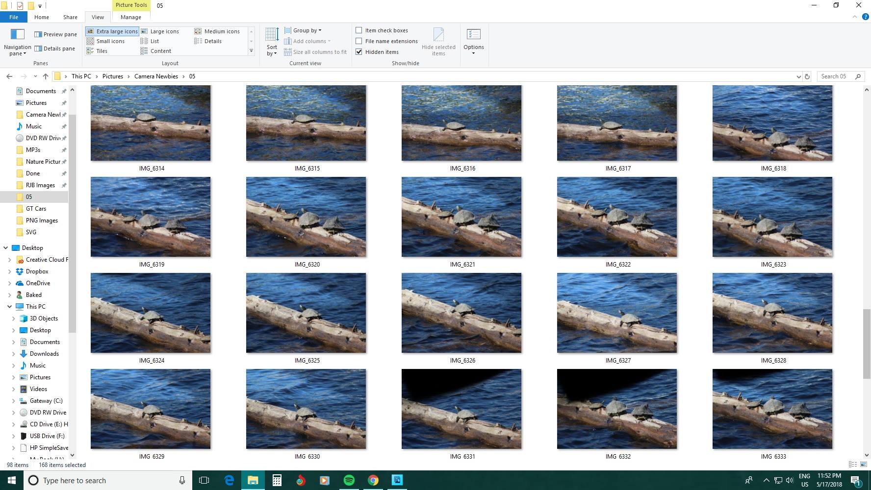

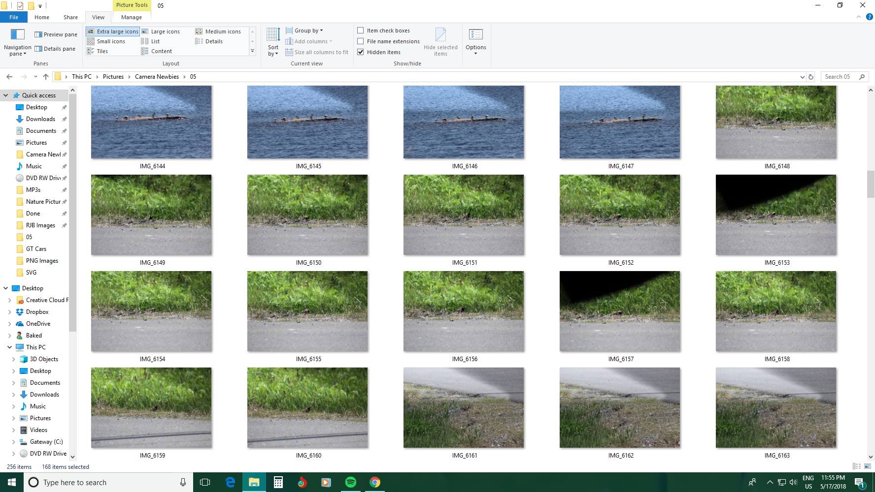

Im getting these shadows or what looks to be ghosting from the shutter. I have tried multiple lenses and multiple program settings. There is a ghosting that happens in the same spot every time but there is a hard shadow that seems to switch sides.
As far as I can tell there is nothtin on the lens but it seems to me tht the shadow is something to do with the shutter. Has anyone experiecned this before?

You have a jammed shutter curtain blade. The focal plane shutter is a series of blades that fold up & down (like blinds). One of your blades is jammed.
The camera needs service to correct this.
Contact Canon support and make arrangements to send it in.

I don't know if a shutter blade is jammed or not but it has failed. They can not be repaired. They need to be replaced. What camera?
