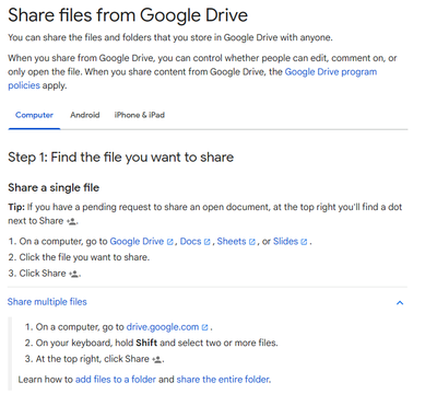

To do so, you need a file sharing interface, such as Microsoft OneDrive (for which you need an Outlook or MS ID), Google Drive, SHAREit or Dropbox.  Others may have programs that they prefer but off the cuff, those ones come to mind.  You connect to the program, probably have to sign up (most are free), then follow the instructions, which usually involve in uploading the files to the program,(perhaps within a folder you create), then the menu system will offer you to create a link to the folder or the files as individuals - check the permissions as you do so.  You then post the link in your post to us.
You might find the Google Drive Program the easiest:  you may need a Gmail account for this, but it's an example.
Alternatively, go to Dropbox.com and open a free account.
