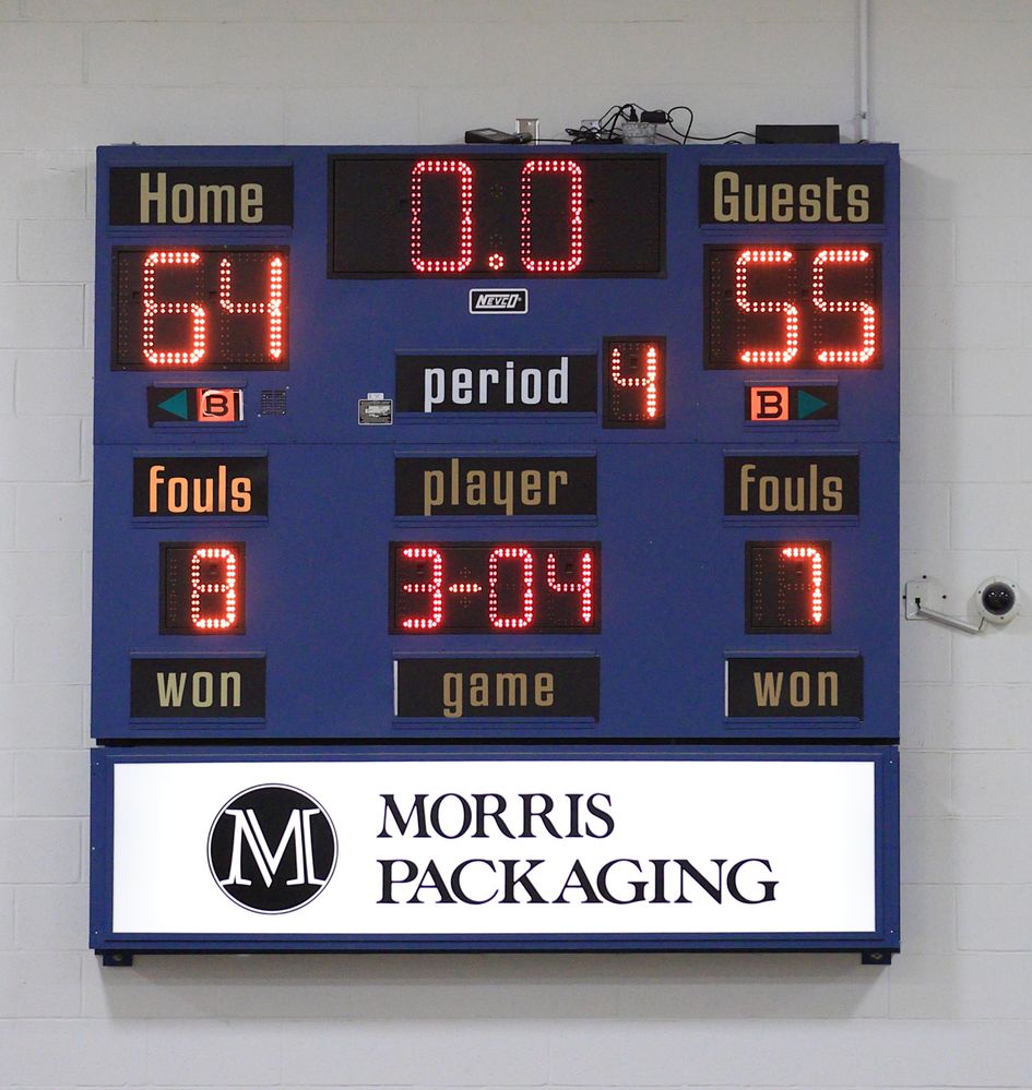

Shoot with a slower shutter speed (use lens with IS if needed) and take several shots.
Typically LED scoreboards cycle the drive between segments at a high rate to keep average current draw (and thus heat) within reason in the controller. So depending upon shutter speed you will also see different levels of brightness between segments as in this basketball capture using a 1DX III with EF 70-200 f2.8 @ 1/800.
Rodger
Segment luminance difference
Rodger
12-09-2023 01:48 PM
Incredible! Brilliant! You're killin' me here! 😆
In my post above I was kinda guessing about the LEDs looking a bit dimmer if shot at 1/250 or 1/125 second. But I never figured I'd ever see such dramatic photographic proof of the effect I was predicting. Especially in less than 10 minutes!
But just between you and me . . . Did you take this shot with the intention of displaying this fleeting event? Or was this just one of those "happy accidents"? C'mon, you can tell me . . ! 🙄
12-09-2023 09:50 PM
Definitely not intentional and I wasn't happy when I was doing post-processing when I got home!
Cameras and LEDs often don't play well together. Another example was a friend wanted to hear the startup sound of my Corvette Z06 and the LED tail lights (DC powered of course but via a PWM controller) which look to the eye like a solid halo appear to my Canon XF-400 as an odd series of dancing segments: https://rodgersingley.smugmug.com/Corvette-idle/n-WBG75x/i-f2bgnmj/A
The family of one of the school officials makes the electronic "dial a down" football markers and I had a heck of a time getting a few good photos of those in a game setting.
